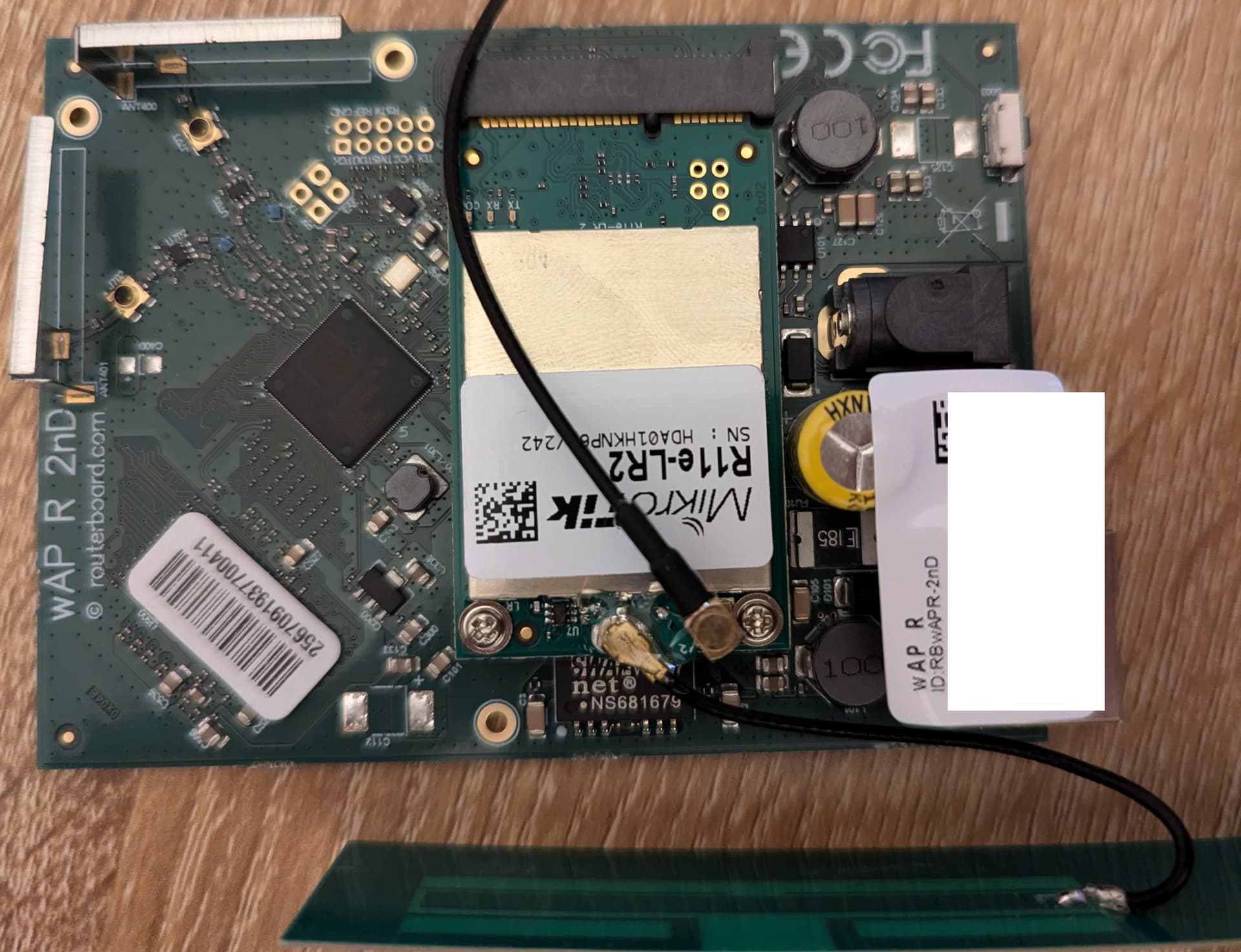

Here a picture of the board - internal LoRa antenna is connected and also the external connector (though no antenna screwed on RF out
Board looks optically fine to me - no burn marks or the like

I bought the board from Galaxus, which I would say is a quite known company taht also sells refurbished devices. Not from some exotic seller on ebay :slight_smile:
Restarted GW after taking the picture: logfile on the GW contains nothing special: ether up, dhcp, ntp, admin login. no other entries. GW is sending status info to TTN but still no data packets
How to electrically check the Antenna/LoRa extension board for functionality ?
