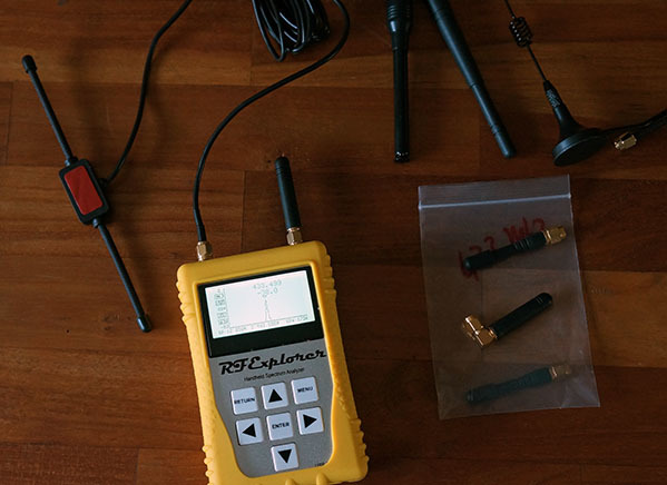

by coincidence I started yesterday testing some small (china) antennas in the 433 Mhz band :sunglasses:

@BoRRoZ what’s your experience like with RF explorer?
Reason I was thinking of getting their ISM combo.
Lawrence
Hi Lawrence, I’m happy with this RF Explorer-ISM Combo.
Its low cost, handheld, and well-built.
Ordered it from Germany and received it in 2 days.
An extra 30dB attenuator I ordered in China :innocent:
