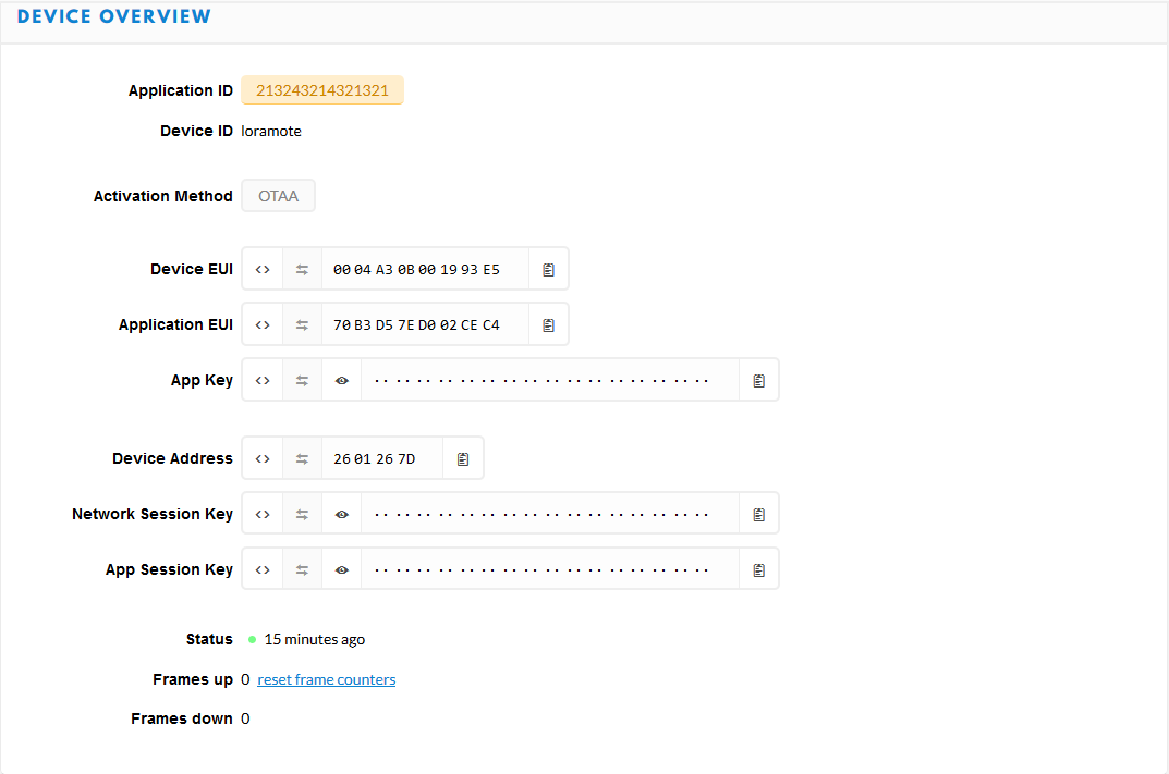

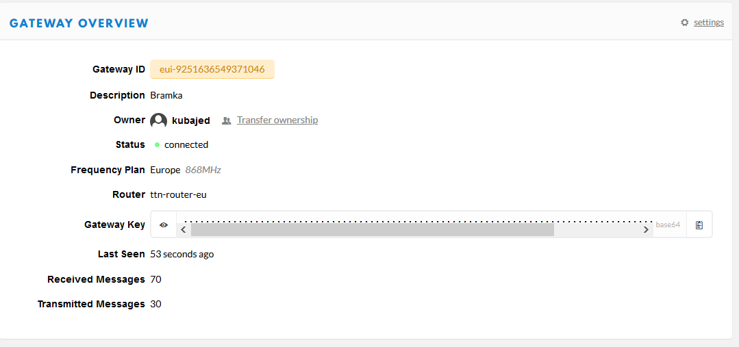

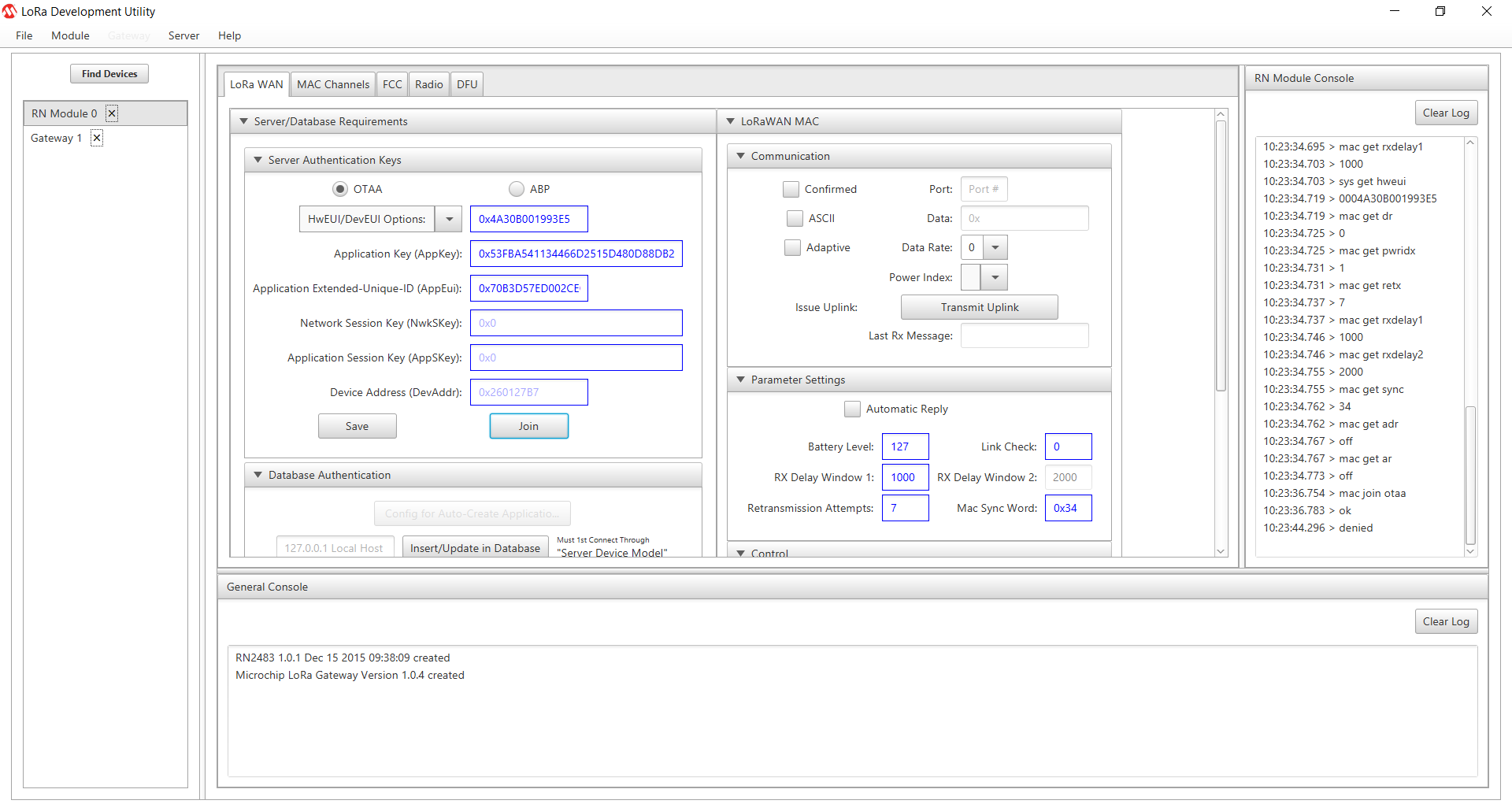

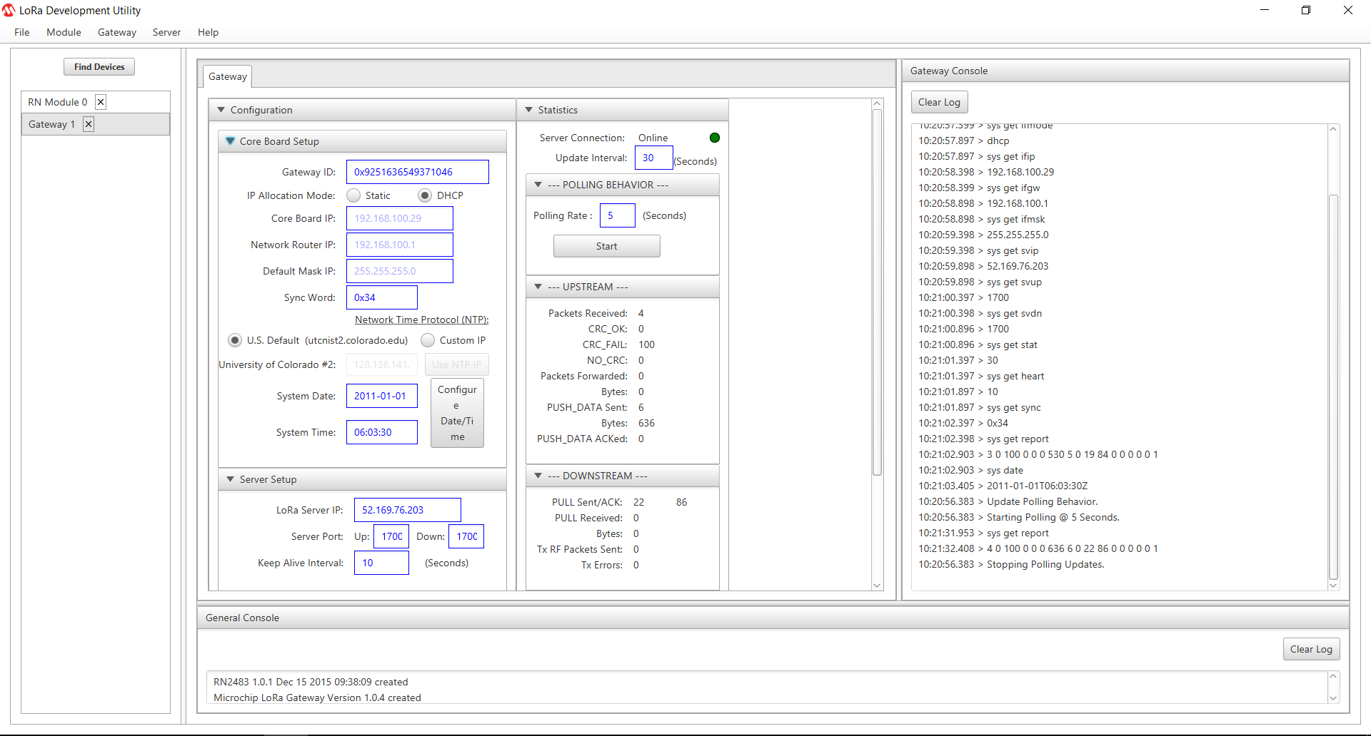

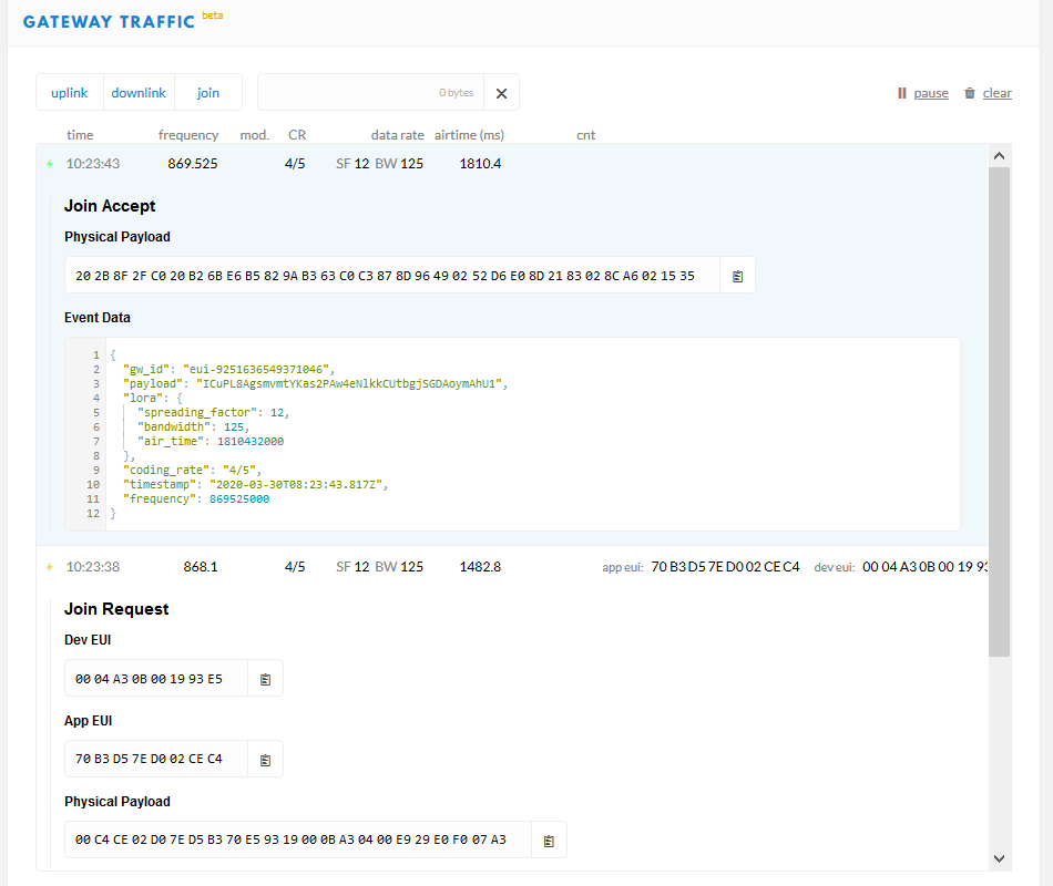

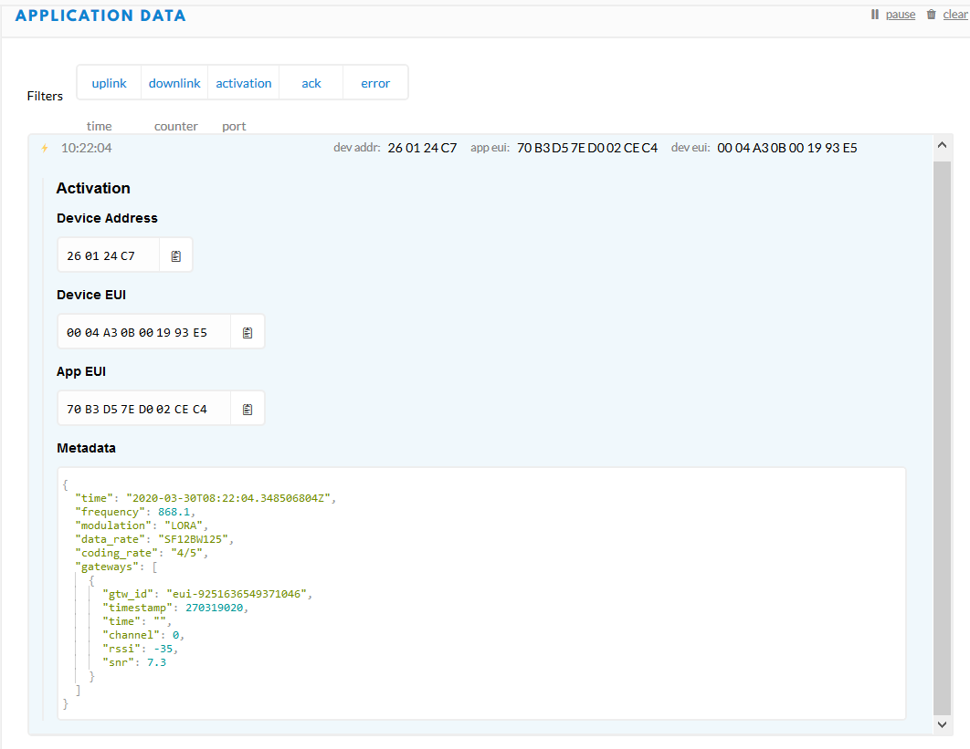

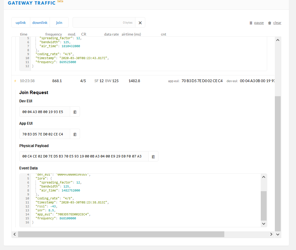

I am using Microchip DV164140-1 set consisting of a node and a gateway. I have configured them using TTN and everything worked fine yesterday, I was able to send messages both ways. Today when I am trying to join OTAA I am always getting “denied”. When I click join in LoRa Development Utility I can see on the TTN console that the node has sent the message, and the gateway has received it. Last activity is also updated.
I am attaching screenshots.
gateway gateway1 gateway2 lora lora1 node 1 node
Don’t use SF12. There are known issues with the RN modules and SF12 downlinks resulting in join failures. (And your uplink use of SF12 results in SF12 downlink)
Your signal strength indicate you can safely switch to SF7. Better performance and less airtime so win-win…
How can I change it? If I change this parameter in node setup nothing is changing.
Have you tried setting the datarate in the communications window?
Thank you, I have figured it out by setting appropriate Data Rate. Now I can connect successfully.

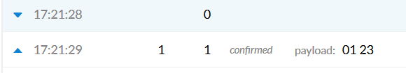

I try to get confirmation of uplink from the Lora Development Utility, I tick “confirmed”, but I don’t get any message back from the server. I can see that the only donwlink is sent on port 0. What is it and how can I get confirmation?
Also, what does that “green” ACK message mean? Previously I have scheduled confirmed downlink on TTN website, is it the confirmation?
conf conf1
The port 0 message is probably the acknowledgment. If you schedule a confirmed uplink the RN module will retransmit the message a couple of times and in the end show an error if no acknowledgement is received,
You will not get an explicit acknowledgment from the module.
The green ack is to signify your module acknowledged the confirmed downlink.
