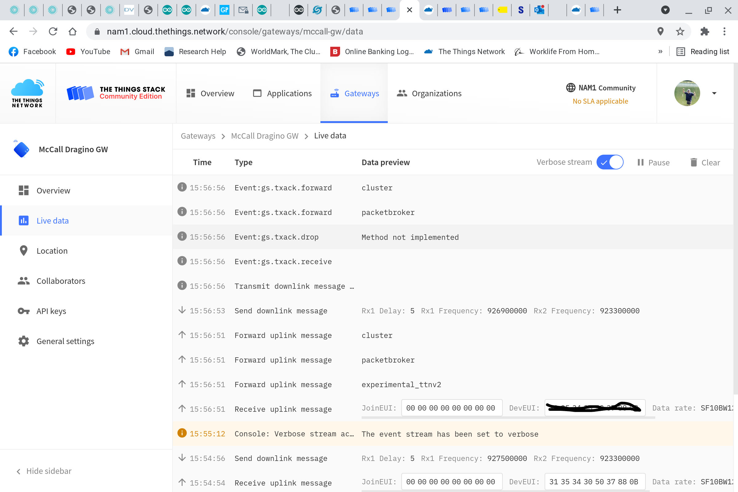

My dragino DLOS8 gateway terminates my mkr wan 1310 device shortly after join with the txack.drop event details here:

I see this TTN V2 in the path (“namespace”:“pkg/gatewayserver/upstream/ttnv2”,) but have confirmed that my previous work on TTN V2 has been deleted. Perhaps it is gateway legacy code that carried over.
I have a MKRWAN1310 FW 1.3.0 end device configured manually with mac v1.0.2 and PHY v1.0.2 Rev B. I get the message consistently when I join via the arduino sketches LoraSendAndRecieve and FirstConfiguration.
Using MKRWAN_v2 - Version: 1.3.2.
Screenshot of gateway log attached.
Any idea what “method is not implemented” or other clues to the root cause?
