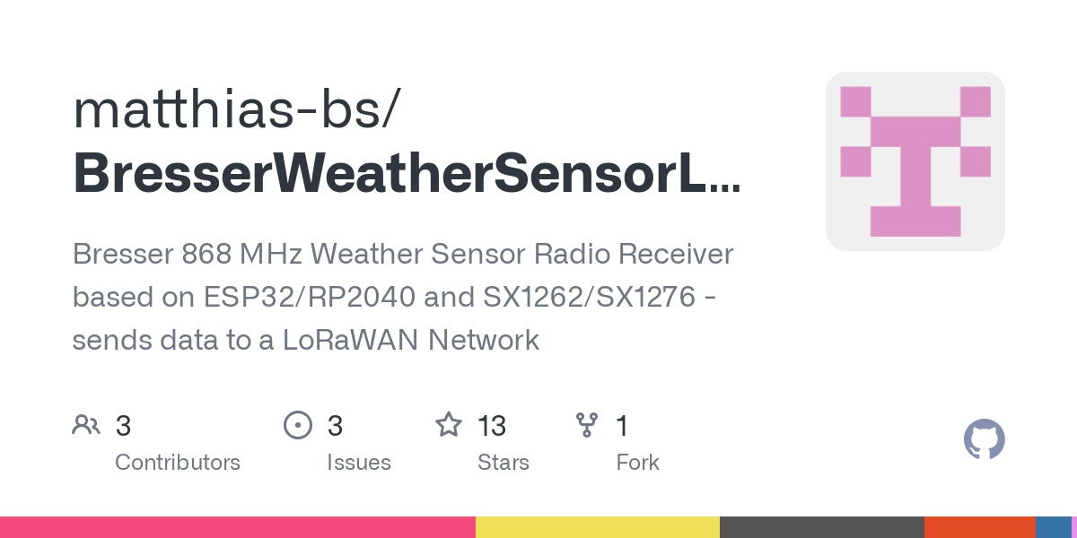

A project that comes to mind is this:
It interfaces somewhat popular Bresser weather stations and relays their data through LW with decoders so that all you need to do is catch the TTN output with an integration.
matthias-bs is a prince amongst gentlemen, from his readme:
- This should not be the first Arduino sketch you are ever trying to flash to your board - try something simple first (e.g.
blink.ino
) to get familiar with the tools and workflow.- If you are new to LoRaWAN
- Check out The Things Fundamentals on LoRaWAN
- Read the excellent article RadioLib LoRaWAN on TTN starter script
Now, @Toulon7559, there’s evidence of the community in action. Steven bought RadioLib LW up to compliance and I wrote the notes. So there are definitely peeps around willing help.
Over to you!
