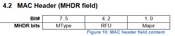

  1. The 1.1 spec says the MHDR should be 20h, but the all the MHDRS above are 34h. Looks like the RFU bits are being used? Do I get it right?

Given your work, I assume that you are a Heltec power user… and I also assume that you know the horrible state of everything Heltec that is not hardware (i.e. the documentation and software).
How in hecks name do you think that Heltec is running a LoRaWAN v1.1 stack? :rofl: :rofl:
Dear stranger, it is a mere LoRaWAN v1.0.2 stack…
Lol Steven the Cello Man, you called it precisely :smiley:
I’m using a Heltec Lora Board running github’s eiannone/Heltec_Esp32_LoRaWan
Are you saying the Heltec stack is mangling the payload? Because i’m not connecting, just listening…
And thanks for the fast response Cello man!

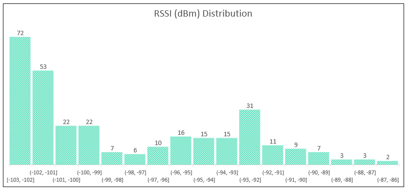

For interest’s sake, I plotted the distribution of a day’s worth of signal strengths on 923300 kHz SF11.

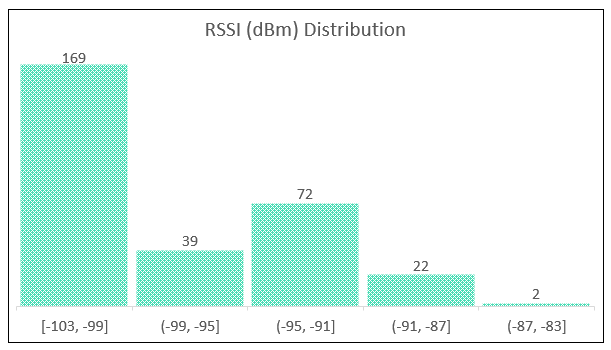

Binning to 1dbm resolution likely excessive given the statistical variance often seen randomly over even short time periods for a single Tx/Rx pair…… look to 3-5 as more typical depending in the dynamics if the associated path reflections and absorptions (easily tested if you set up a pair and monitor……especially over longer ranges.)
Thank you for the advice Jeff-UK.
I re-plotted with a bin size of 4dB.
The raw data for the graph is in post #6 above.
