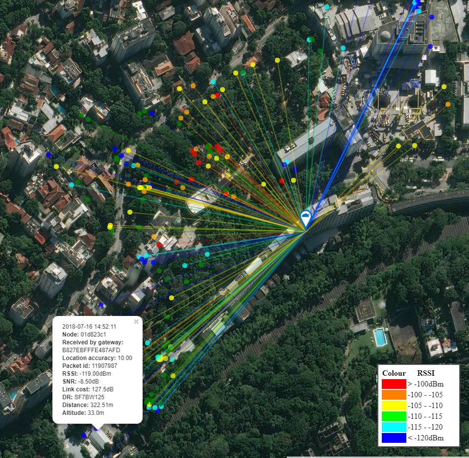

Today we already have a LoRa Gateway installed at the top of the main building of PUC Rio and during these last days I have been performing a LoRa network coverage mapping on Campus.
The PUC Rio is located in the neighborhood of Gávea in Rio de Janeiro and here the topology is of a valley.

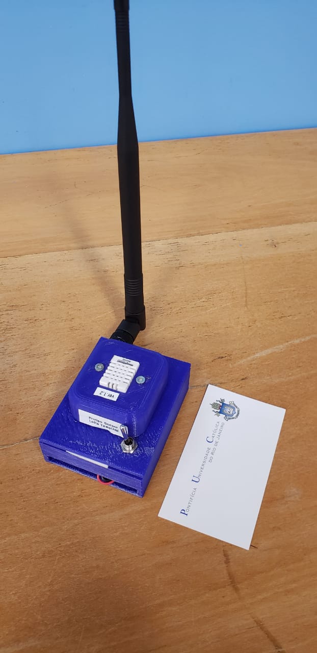

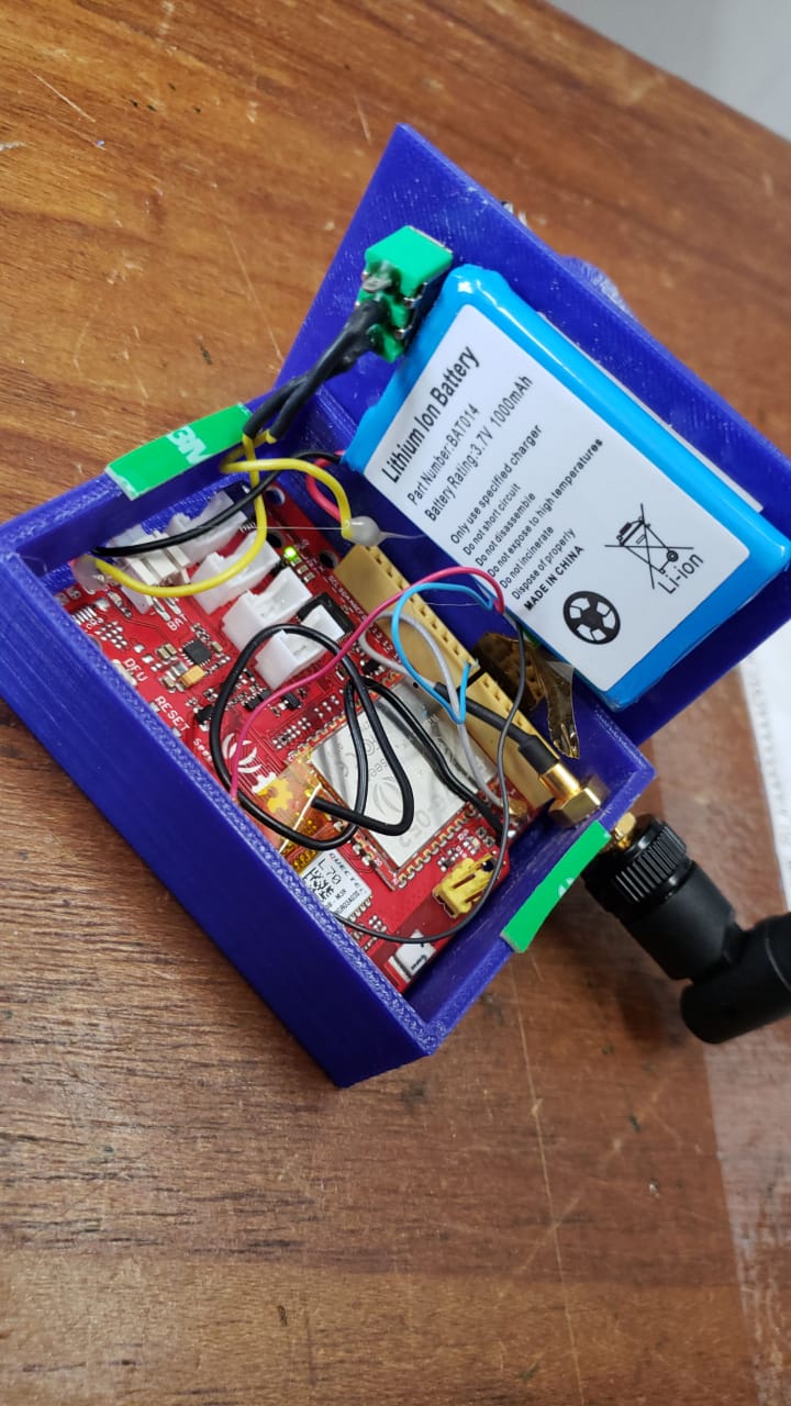

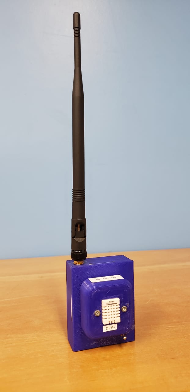

A Seeduino LoRa Hat was used.
You’ll also see a prototype model of the first Node with temperature and humidity sensor.
I also took advantage of the coverage test in other districts such as Lagoa, Ipanema, Leblon, Humaita and Jardim Botânico.
You can view these coverage measures on the map. Temperature and Humidity were sent in all points.

TTN MAPPER LINK:
https://ttnmapper.org/special.php?node=01d823c1&date=2018-07-17&gateways=on
