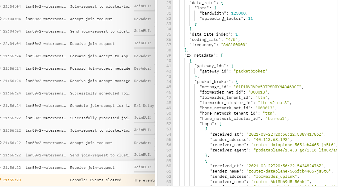

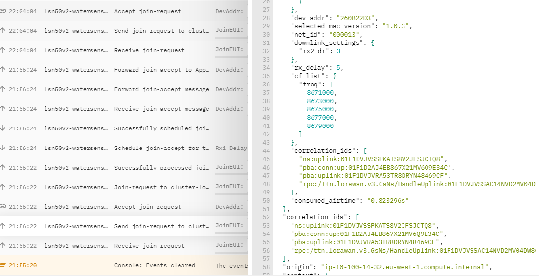

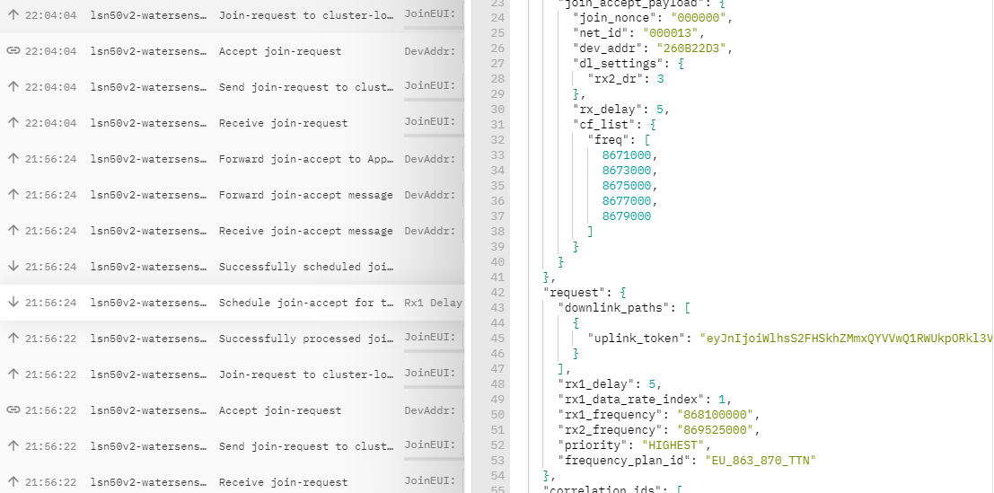

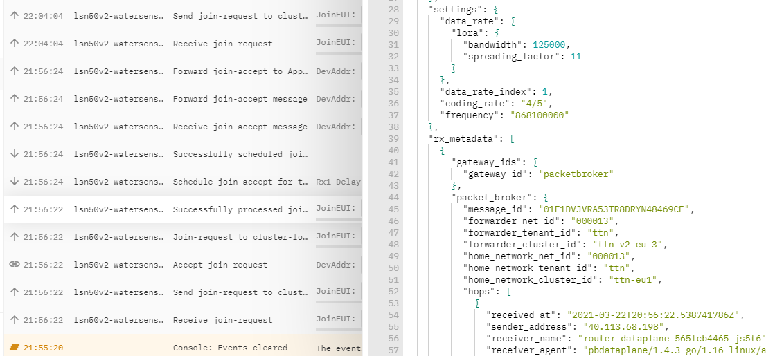

Hi there,
I am trying to get my LSN50v2 to join TTN v3 via OTAA but it does not seem to receive the join accept message.
Here is an excerpt from my console.
At first, I thought it was the RX1 Delay of 5 seconds. LSN50v2 uses 1 second by default but changing it to 5 seconds did not solve the issue.
I think I have chosen the correct frequency plan: Europe 863-870 MHz (SF9 for RX2). My device is EU868 and shows an RX2 datarate: DR3.
Could this be an issue with the ADR, which is set to on?

That applies only after the join process is completed; the join accept itself has to used standard RX2 if it ends up transmitted in RX2 rather than RX1 - but the network side log appears to show RX1 used, so that isn’t the problem in this instance, still you should use the standard setting when trying to join; the network will command the customization automatically.
Similarly, ADR only applies after the join process works.
Same for RX1 time customizations - the join accept RX slots have standard timing, custom timing only comes after.
Does the node give you any way to determine what it is trying to do?
How far is the node from the gateway? Both too close (within a few tens of meters) and of course too far can cause problems.
As mentioned that is the wrong setting. Set it back to 0.
OTAA takes care of that, leave it at 1 second.
These values do not make sense. RX2 delay is always RX1 delay + 1 second. So if you ever need to modify them by hand, make sure RX2DL is set to 6000 if RX1DL = 5000
From your excerpt we’re unable to check the data rate of the packet received. Please provide that information as well. And don’t bother crossing out all those values, all of them travel in clear text over the air so anyone interested can listen for them. If you want to prevent someone from across the world registering the same device just blocking the DevEUI is sufficient.
