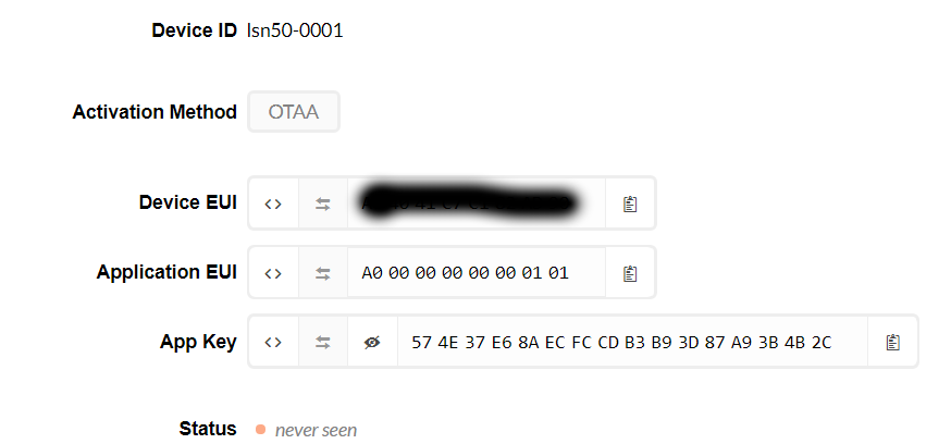

I have a new Dragino LSN50 V2 and can’t get it to join the Network.
I have entered the DEV_EUI from my device in my application. During the join-request I see this DEV_EUI, so I assume it is correct.

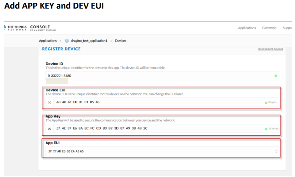

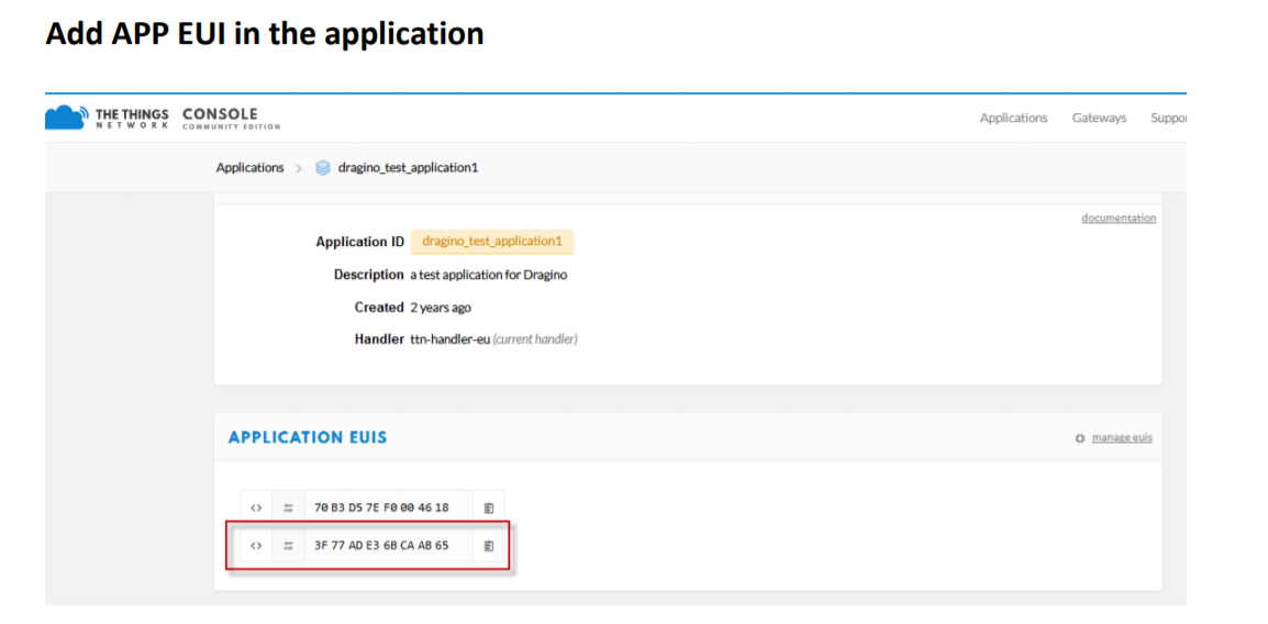

What I do not understand is the part 2.2 Step 1 of this manual https://www.dragino.com/downloads/downloads/LSN50-LoRaST/LSN50_LoRa_Sensor_Node_UserManual_v1.7.1.pdf
It says I should enter the APP_EUI as shown

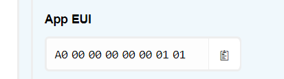

But in the join-request there is another APP_EUI:
Which one is correct?
Or do I have to upload the APP_EUI to the LSN50?
And what about this? image

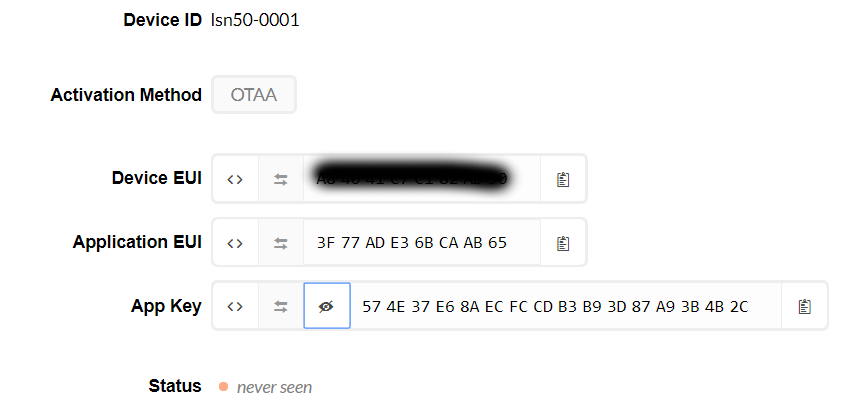

I entered the App_KEY but it’s still not joining.
I’ve used this config
and this config

Go to application settings and add the AppEUI as provided by Dragino. Then go to the device settings and switch the AppEUI listed there to the newly entered AppEUI.
Which APP_EUI? The one from the manual 3F77ADE36BCAAB65 ?
Or the one submitted by the device during the join request A000000000000101 ?
As you can see in my last two pictures I’ve tried both of them and they are not working.
Are some of these EUI reverse?
You need to use the AppEUI and AppKey provided with the device. There should be a sticker on the inside of the lid of the box with the correct values for your device.
Thank you very much!
There was a second sticker inside the box, which I’ve missed…
Thank you!

On the label it is written: APP EUI A000000000000101 but it does not work. How to do?

My EUI app is: A000000000000101

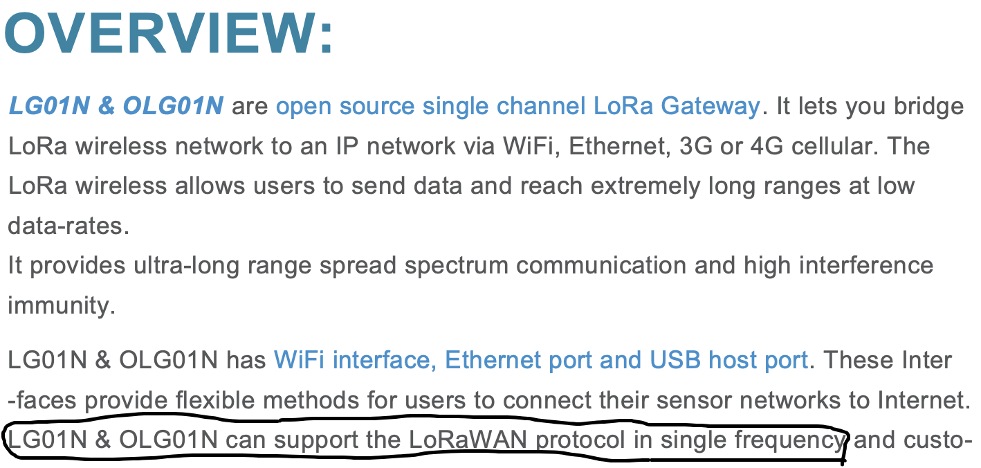

Here is info from their documentation, that LG01N can support LoraWAN protocol.
It does not support LoRaWAN and should not be used on TTN as it causes issues for other users (and yourself). Please disconnect it now. Dragino explicitly calls those devices LoRa gateways not LoRaWAN gateways on their website and in their documentation.
Yes, you are using incompatible hardware and not using OTAA as recommended. As a result you are running into issues. Disconnect the LG01, use a proper LoRaWAN gateway and if you still have issues we will will provide support. For incompatible hardware which should not be used we do not offer support on the forum.

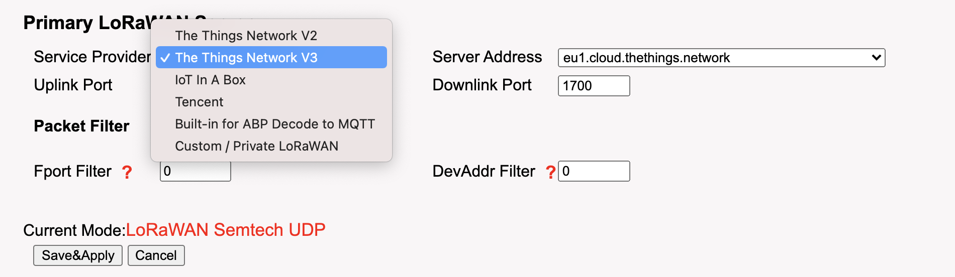

They even have pre-defined settings for TTN image

OK, so why the hell their latest firmware has these predefined V2/V3 settings for TTN if they are not compatbile? Any other services that I can use? Don’t have an option to quickly replace this one with another gateway.
