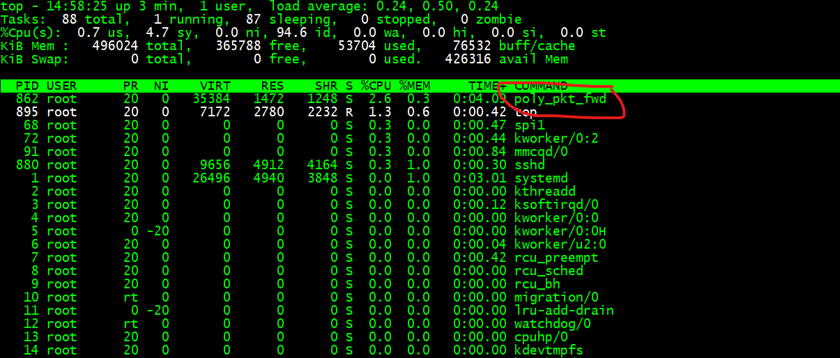

now waiting for the reboot
Yep, however mine is running BalenaOS and MP forwarder. I haven’t looked at the original software for years.
…and it’s OK now,
So yes, I modified the lorank.service script, because /root/lorank8v1 does not exist.
