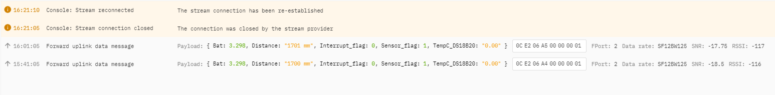

I got this error a few minutes ago. I hope there are no private numbers on this screenshot.Screenshot (2)
Cant see the message clearly (need glass), but looks like your gateway is losing connection with the server.
So you internet is up and down.
That’s not an error - indeed it doesn’t say it’s an error - it just tells you what happened - the TTS console server disconnected and your web browser reconnected.
Oh Okay… that makes sense…

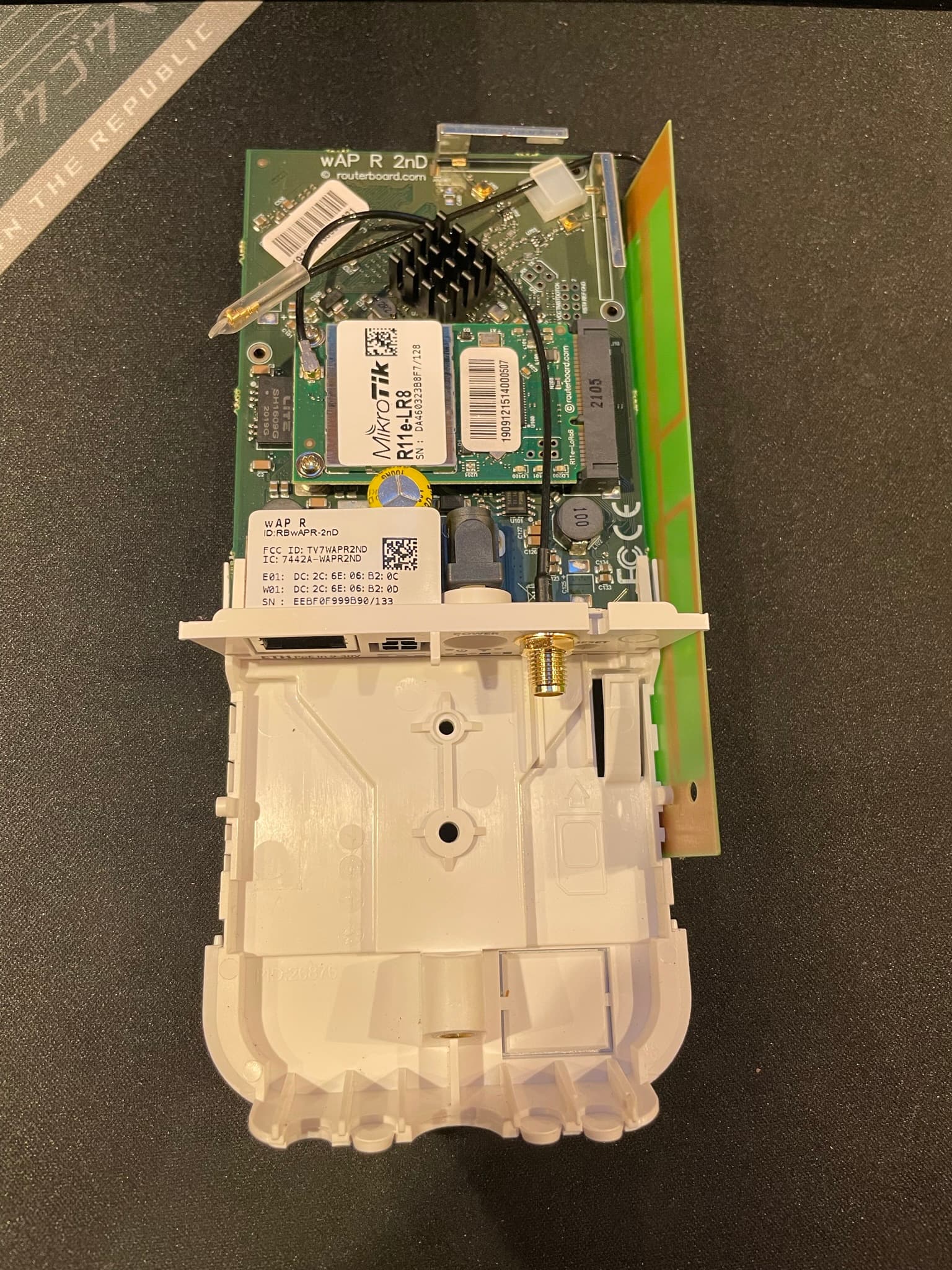

I think I (you) found the problem… :smiley:
The other cable should be connected.
IMG_1080
The black cable in the plastic sleeve needs to be connected to the PCB
Yes. I know… I can not believe that’s connected like that without an sticker which is saying that the external port is connected.
