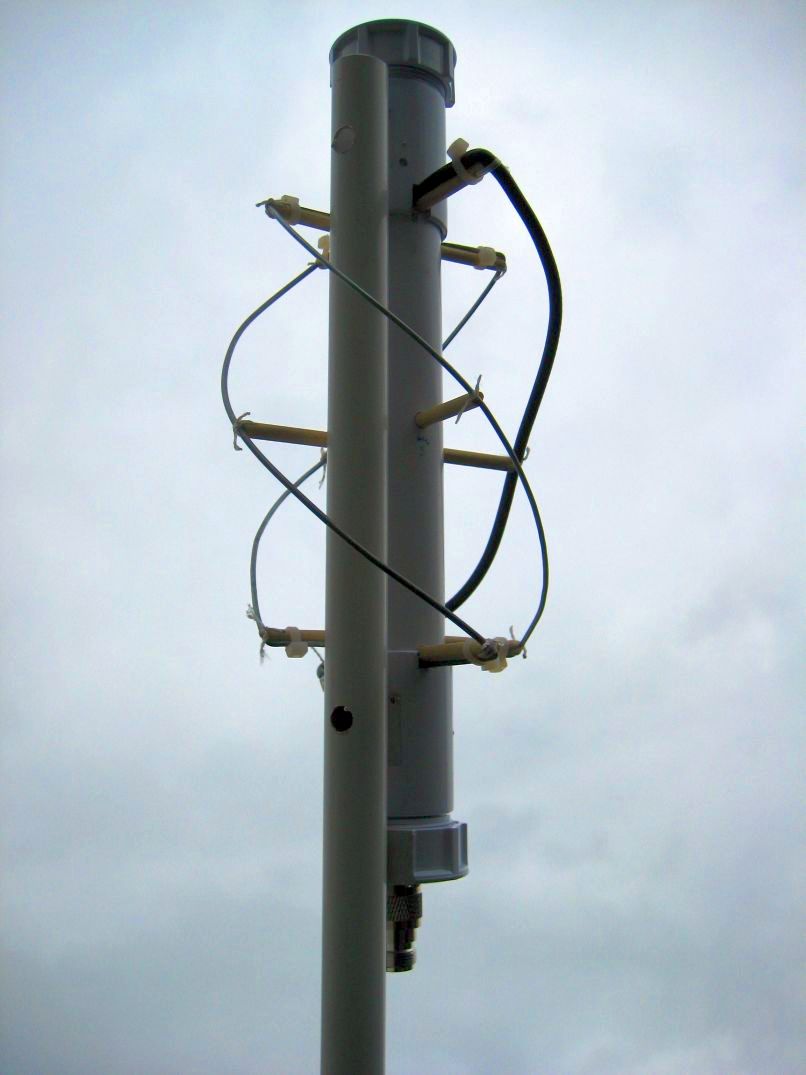

A gain antenna that has a circular radiation pattern out of the long axis of the antenna is the quadrifilar helix, which is easy to build and has a gain of around 5dB. Very useful for communicating with satellites when they are overhead.
I built one for 434Mhz out of bits of wood dowel, ex BBQ stand wire and plastic plumbing pipe. Very effective it was too.
