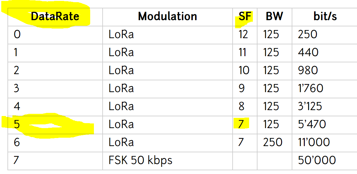

I suppose you try to set the Spreading Factor? DR sets the Data Rate, so you have to use DR5:
LoRaWAN Data Rates - blog.dbrgn.ch
best regards
Danny

Just see the link: In EU for example SF7 corresponds to DR5
Yes but I have a US frequency
In you example why DR5 and not DR6?
If using in US on 915 then you have the 400ms limit or dwell time to consider and SF beyond 10 not an option…SF 7 allowed and just fine
and data basically the same…

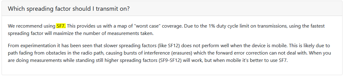

Hm. Because TTN is suggesting SF7BW125:
Data Rate should be as fast as possible to minimize your airtime. SF7BW125 is usually a good place to start, as it consumes the least power and airtime. ( Limitations | The Things Network) - actually I never tried the 250kbit bandwith. So DR3 should be your choice
