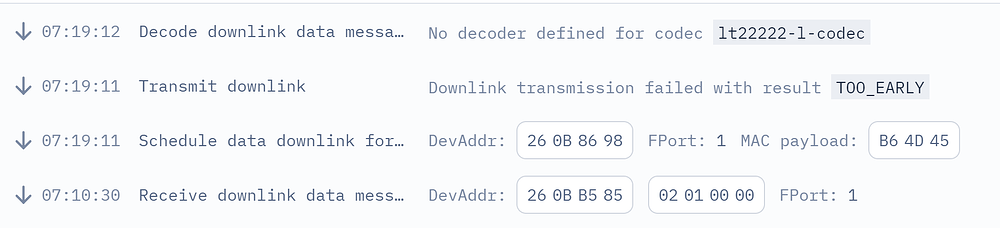

Hello togheter,
I am using dragino LT-22222-LT togheter with an Dragino LPS8v2 Indoor Gateway.
When I am sending over API an downlink to my device it takes a lot of time to send the downlink to the device.
I just checked to documentation for CLASS C and added to my downlink call the class_b_c function. But also this is not working in minutes. The downlink is still without respond in the dashboard. Sometimes I also get the error TOO_EARLY. The devices are all standard configurated with Class C activated in the dashboard. Or does I need to use the CLI to update the device?
Class C Settings | The Things Stack for LoRaWAN
"downlinks": [
      "frm_payload": "AgEAAA==",
      "f_port": 1,
      "priority": "NORMAL",
      "class_b_c": {
        "gateways": [
            "gateway_ids": {
              "gateway_id": "eui-a84041ffff21759c123"
        "absolute_time": "2024-11-07T07:10:00Z"
