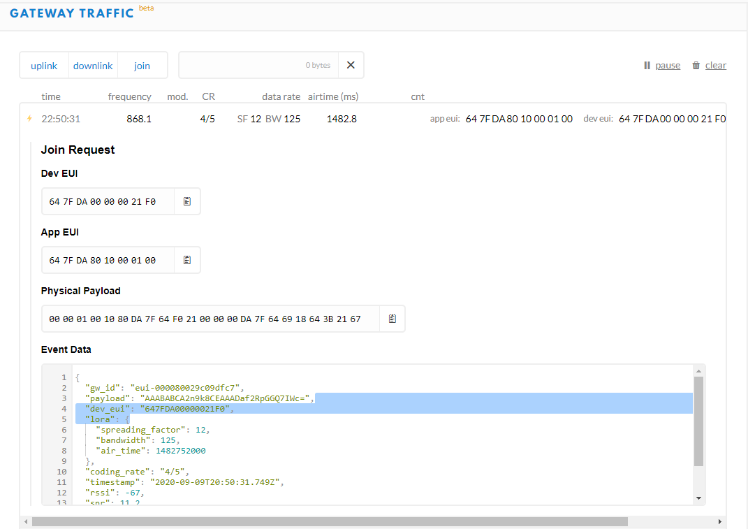

I have a kona home sensor that I have added to my network of LoRaWAN devices. After adding it I observe that it appears in the gateway traffic but I was not able to add it correctly to the application because it appears as “never seen”.
I have followed the following steps:
I have created a new application, to which I have changed the AppEUI to match the one that comes in the sensor. Next, I have added the device with the corresponding DevEUI.
The other parameters I have left as they come by default.
Post some of the raw packet contents and metadata as sent as seen by your gateway.
infoGw
What about the secret AppKey? See also Registration of node with pre-configured LoRaWAN keys.
