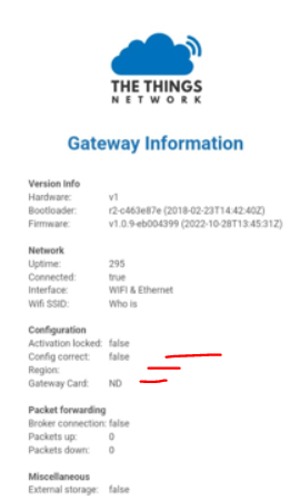

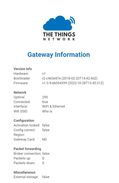

I am uploading the gateway information at 192.168.1.76/info. Region is blank, Gateway Card is ND. Both Activation locked and Config correct false. Are there some hints? Shouldn’t be Configs correct since 3rd LED does not fast blink?

I am confused here weather at this point Config correct should be true and Gateway Card detected and Region too. Shall something be different even though activation is not ultimately successfully?
This is confusing.
