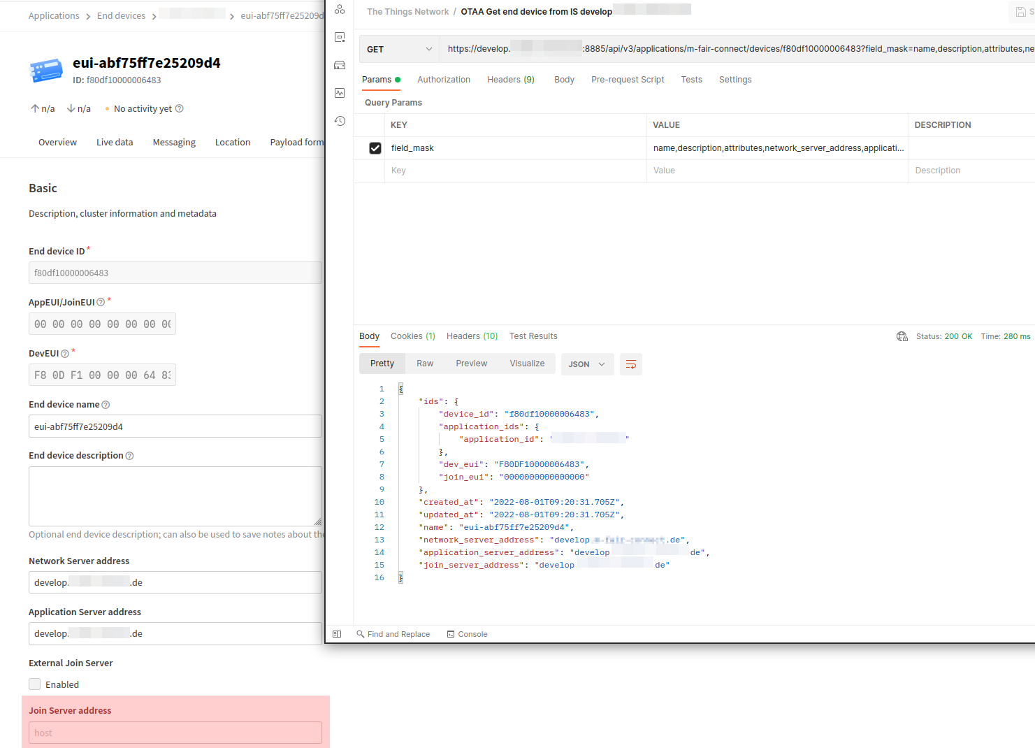

When I create a device via API, some fields are not set (the value doesn’t show up in the browser view), for example the join_server_address field in the identity server:
When I query the IS the field is set, but when I check it in the web app, it doesn’t show up.
I created the device with POST to
https://develop.XXX.de:8885/api/v3/applications/XXX/devices?field_mask=name,description,attributes,network_server_address,application_server_address,join_server_address,locations
"end_device":{
"ids":{
"device_id":"f80df10000006483",
"application_ids":{
"application_id":"XXX"
"dev_eui":"F80DF10000006483",
"join_eui":"0000000000000000"
"name":"eui-abf75ff7e25209d4",
"description":"",
"join_server_address":"develop.XXX.de",
"network_server_address":"develop.XXX.de",
"application_server_address":"develop.XXX.de"
