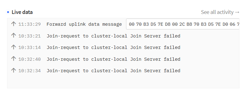

I have been trying for weeks to get my LoraWAN end node working. I’m using a local provider for LoRaWAN with no success, so I’m also trying my luck here.
I haven’t had anything show up in the console until now. It’s a “join-request to cluster-local join server failed”. I have verified my MIC with an online package decoder, I’m generating my MIC based on the join message and encrypt it with the appKey. I followed the AES_CMAC algorithm so I’m fairly sure this isn’t the issue.
However, could it be possible that I’m not sending with enough power? Like there is some sort of issue with the hardware that prevents it from sending powerful enough? I’ve set the registers so that the TX_POWER is at the maximum that’s allowed here.
I’m completely lost as to why I’m suddenly even receiving anything but then, I can’t reproduce it either, it’s not a loop, it’s a few messages an hour ago and I haven’t been able to repeat it since.
I simulated an uplink message after, which was fine but there is no activity anymore.
Does anybody have an idea as to what’s going wrong?
“name”: “ns.up.join.cluster.fail”,
“time”: “2024-05-02T08:33:21.595194742Z”,
“identifiers”: [
“device_ids”: {
“device_id”: “eui-70b3d57ed006722f”,
“application_ids”: {
“application_id”: “voorspelbaaronderhoud”
“context”: {
“tenant-id”: “CgN0dG4=”
“visibility”: {
“rights”: [
“RIGHT_APPLICATION_TRAFFIC_READ”
“unique_id”: “01HWW6ZJNVYHMM1T2K94J7C6RH”

Hi. I’m using a dragino TrackerD that I’m programming myself through the ESP-IDF framework.
I’m not using any library and merely writing my own code through writing over SPI. I have verified that my device is transmitting a signal.
I have not implemented a join-accept routine, rather I’m checking if there’s anything at all being received by checking the interrupt flag.
I’m constructing my join-request and then shoving that into the SPI FIFO buffer, then putting the SX1276 into “tx” mode so it transmits. After, the device is set back into idle mode.
