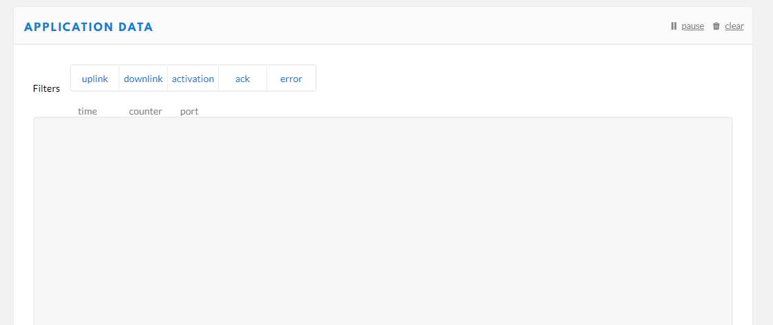

Do you see you join requests in the TTN console in the application data? (You need to open that page before sending the join request as it only shows life data, no history)
No actually i dont see anything in the application data.
It is blank.
