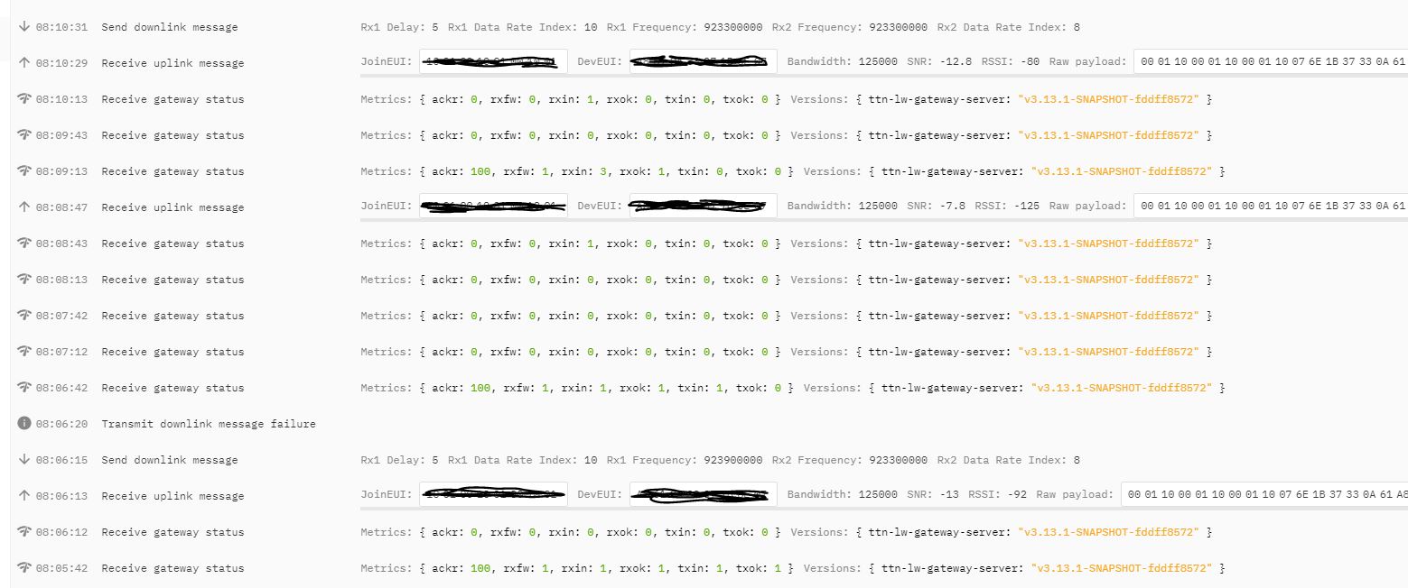

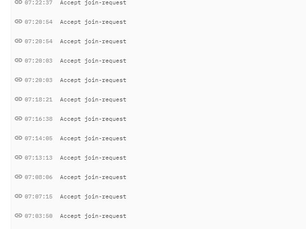

Hello, after repeatedly retrying example tutorials on connecting an MKR 1310 through a Dragino DLOS8. In the application page I have the join request being accepted, but the MKR never receives this information. I am using the MKRWAN firstconfig example, and after adding in the APPKEY there is a long pause before eventually saying that something went wrong. This connection is being made through OTAA as well. I have doubled checked the APPEUI, APPKEY, Frequency bands across all devices (FSB2), changed the regional band to PHY REV B (based on another topic about mkr1310), and have essentially exhausted my research efforts to find the issue. Apologies for my ignorance around this communication style, I was put on this project about a week ago, and will gladly provide any other required information. Thanks in advance.

I believe it is registered, by creating an end device that is being “seen” every couple of minutes. If this is what you are referring to.

Are you saying it’s seen but not joining?
Where are you seeing it - the gateway or the app/device log?

Well now this is peculiar… When I plugged the MKR back in the serial monitor posted that it was ready to send a message. I typed one in and it is successfully being transmitted in the device log and can be decoded back to what I sent. I don’t know how its working now after 2 days of repeatable road blocks but wow you are a miracle worker haha.
