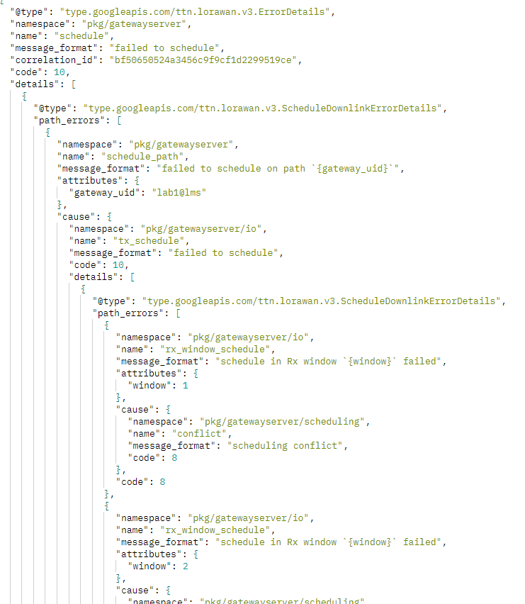

New Problems!!!, now sensors again failes to connect due to download issues
Is this related to the TTN community network? Looks like a private V3 installation? Or, if it is a TTI V3 instance, then you have much better ways to get support:
(Also, please don’t post images for what is just text. See also How do I format my forum post? [HowTo])

Yes it´s a private instance of V3, and is it a No…no to post images? they are fairly small in size if thats the issue…

No, it’s that search won’t see the text, and one cannot copy/paste/quote from an image.
