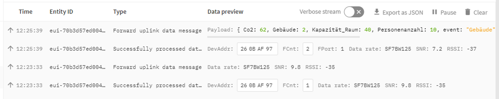

This is the live data of the newly set up End device bevore changing the payload. I am looking at Applications->Live data
After changing the payload, nothing gets displayed here

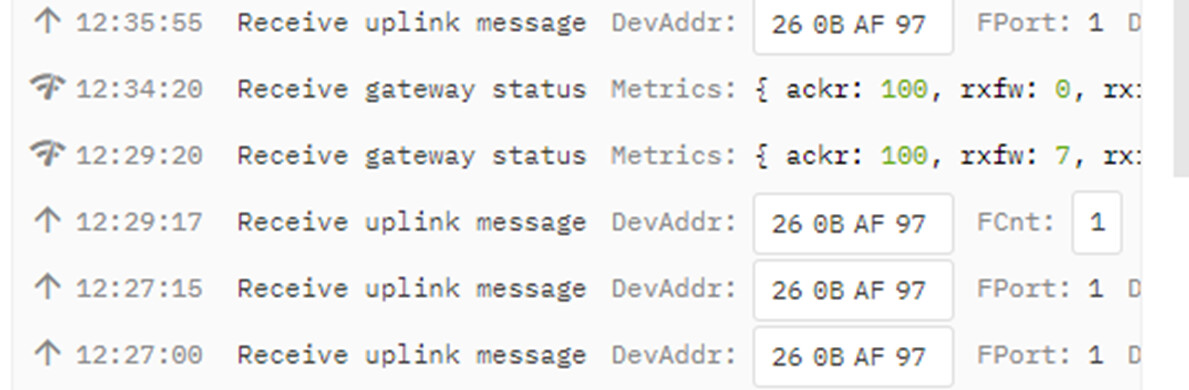

This is the live data of the gateway. Gateways-> Live data
At all times it receives a uplink message, even when no data is shown at the application site
Looking at the second screenshot it seems you uplink counter is reset. The uplink counter needs to increase from the previous processed one to have the packet processed by the back-end. Lower values are considered a replay attack.

Uplink counter shows as FCnt in your screen shots. What is might be called in the software I don’t know (depends on what software you use).
Does the ESP reboot between transmissions? Because it clearly resets the (LoRaWAN stack internal) counter.
