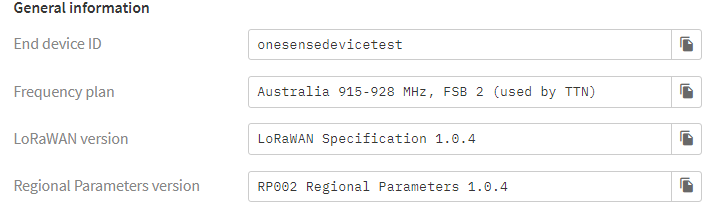

However, I’ve noticed that devices fail to connect when I use these versions of Regional prameter and LoRaWAN specifications:

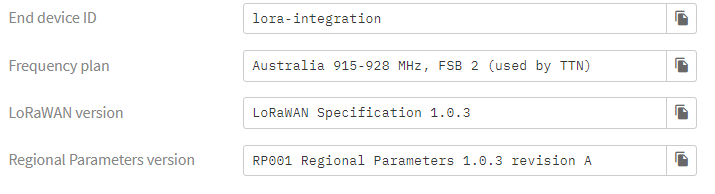

And working fine with these versions

Which version you need to use depends on the stack you are using on your device, LoRaWAN 1.0.4 stacks are few. Most are still 1.0.2 or 1.0.3. The repo you based your code on is based on MCCI LMIC which states ‘ The library has only been tested with LoRaWAN 1.0.2/1.03 ‘. So 1.0.4 was never going to work.
