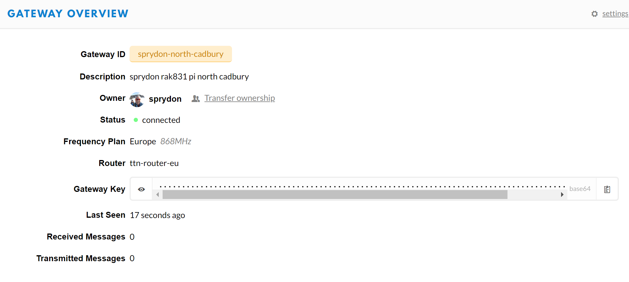

so this is the console in ttn

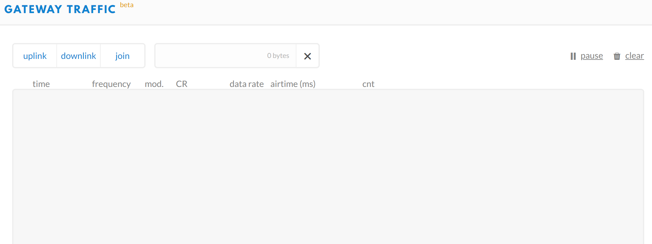

and this is the traffic view - empty - because the CRC check fails on the actual gateway?
crc error could be from a non lorawan packet.
start with leaving your browser window open and then join your node on the network.
you should see at least your node trying to join (ABP / OTAA)
Is your gateway working… do you see data from other sources being forwarded ?
