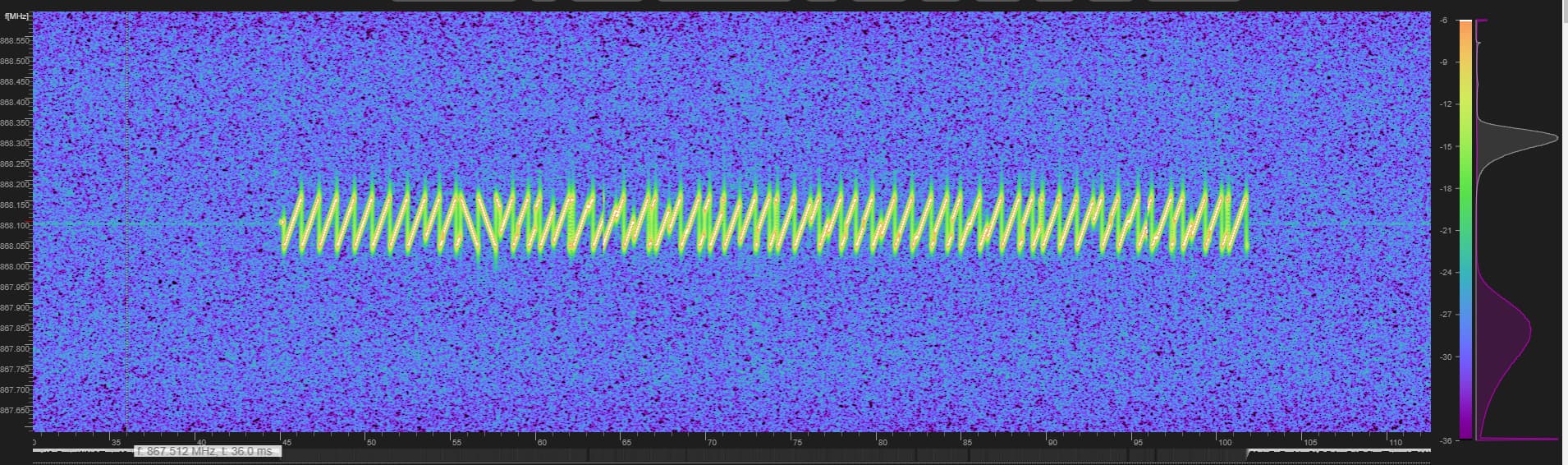

Have an SDR (Software defined radio) (Nooelec R820T SDR USB+) and my utilities provider is using Lora to send data.
I ran a capture overnight using rtl_433 on 868.1MHz to see if I can capture it and it looks like I can.
However my problem is the signal processing. Is there a in silico gateway that I could feed raw signals or demodulated signals as files or over UDP or MQTT?

I manage to capture something in the Lora signal range with research tools (GNU radio + gr-lora) with some calibration it should be possible to transmit decoded signals over UDP but either need to find a consumer for it or rethink my entire approach which is probably more likely… meter has M-Bus cable that I may attach some kind wireless transmitter.
