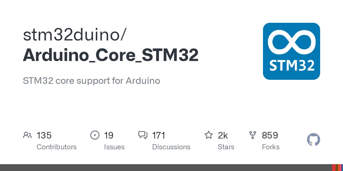

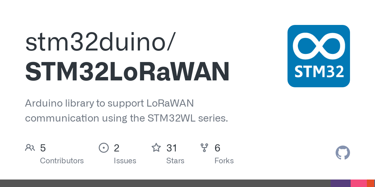

I found the following information:
→ STM32WL55JC Nucleo WL55JC1 2.1.0 LoRa support not available
→ This library provides support for LoRaWAN communication using the STM32WL55 microcontroller …

@daa792, this is an interesting topic.
In the past I’ve used this port of stm32duino with the Nucleo WL55JC1 board and got it working.
Cheers!
I was able to get a seeed lora-e5 mini working with this library:
This board is not be exactly the same as a nucleo-wl55jc1 board, however I used it with the following platformio.ini configuration (which specifies the nucleo_wl55jc):
[platformio]
src_dir = .
[env:default]
platform = ststm32
board = nucleo_wl55jc
framework = arduino
upload_protocol = stlink
debug_tool = stlink
monitor_speed = 115200
lib_deps = https://github.com/stm32duino/STM32LoRaWAN
With this configuration I see that the node sends an OTAA join and receives a device address from TTN. So I’m pretty sure that this works with a nucleo board as well.
I prefer platformio over the arduino IDE. I use platform CLI + editor of my choice.
So I’m using the arduino platform, just not the arduino IDE.
With platformio, you place this platformio.ini file next to the .ino file, then compile + upload it from the command line using:
pio run -t upload
The .ino file I used is this one from the examples/ directory (with my own OTAA credentials instead of all-zeros key):
