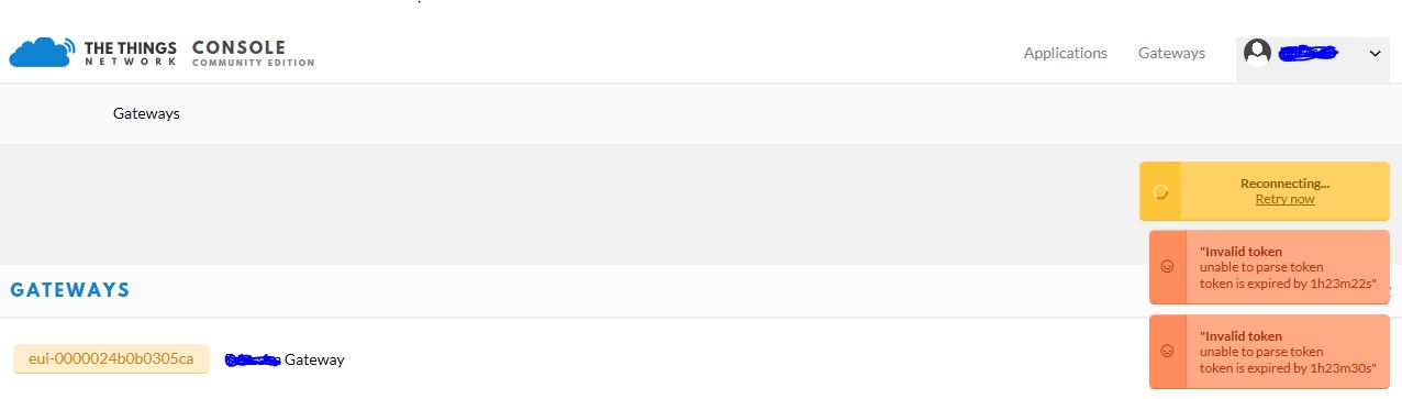

"Invalid Token" in Console
I have defines Kerlink Gateway. The communication looks like ok.
But in The Things Network - CONSOLE, I get this message :
  • Reconnecting …
    Retry Now
and thousands of red messages :
“Invalid Token
unable to parse token
token is expired by xxhyymxxs”
Invalid Token
I couldn’t find any solution so far.
If someone is able to help.
Thanks in advance.
