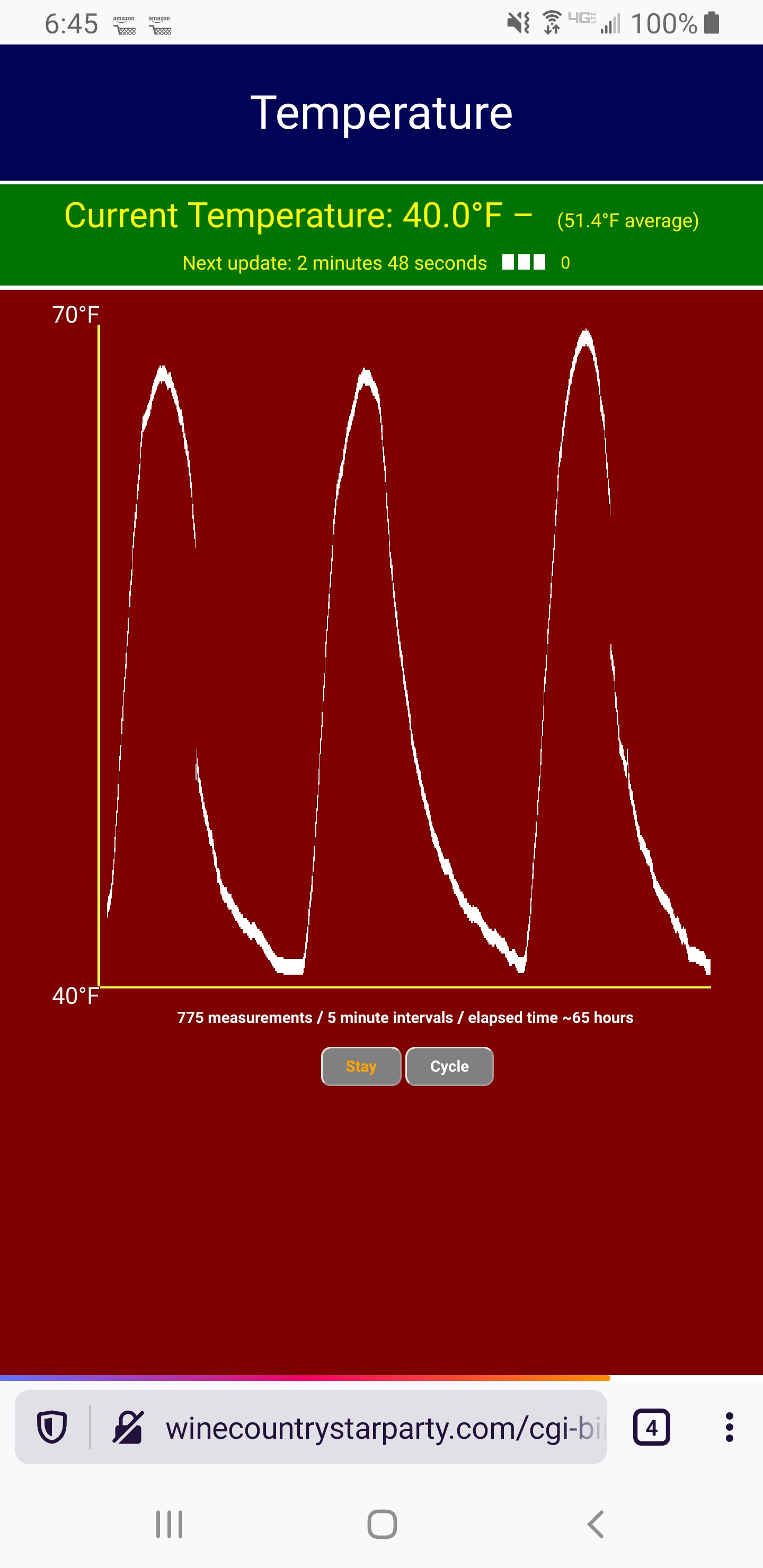

My Arduino / Dragino LORA shield combination works well as a weather station, except it has started to intermittently stop sending data. The screenshot below shows ‘gaps’ in the sent data that occur at the end of the day. The only thing I can guess is that during dropping temperatures the circuitry fails to send data to my TTN Indoor Gateway. The Gateway is 100 feet from the node, and there is window glass and roofing between it and the node. I am using SF7, and will try SF8. When I reset the Arduino / Dragino shield pair manually, data is transmitted once and then the gaps continue when the 5 minute interval in my sketch is reached. Eventually, the weather station starts to transmit on its own again.

Screenshot_20201130-064527_Firefox
What other things could be going on in the local environment that are end of day / drop in temperature related? Perhaps some HVAC is starting up and causing some local interference. Or additional blinds on the windows? Or power fluctuations?
Those are good questions and considerations. No blinds. No HVAC. The only thing I have not mentioned was a concern about condensation, but I don’t know why that would prevent timed data from being sent, and not data from a reset.

These outages look like they’re at the same time of day though varying duration, it’s worth wondering if your gateway somehow loses connectivity to the back end. If you have the TTIG that’s a bit notorious for dropping off wifi, for example.

It was the first thing I thought of with the problem of this thread, but then I saw that int he problem that kicked off this thread, the issue wasn’t at the minimum temperature, which was seeming to get through (though it would be nice to see individual points without whatever smoothing…)
