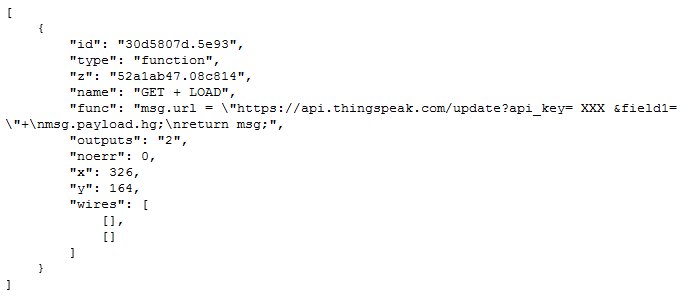

I did some research on this problem and came up with the following Node red solution for thingspeak ;
An object named { hg } is prepared for a HTTP request ;
nr-func1
