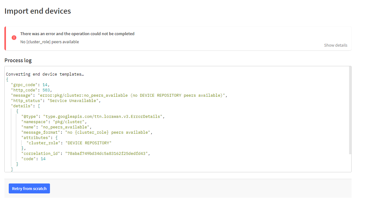

I want to add multiple devices with the import function, but then I get the message:
There was an error and the operation could not be completed.
No {cluster_role} peers available.
I hope someone can help me with that.
Greetings,
Yari
Hi i have the same problem today! It was working fine yesterday with the same file I was still using today.
If a single soul will find this at some point in time. I had to remove the “band_id” field from the csv. If you do not have this field, just try removing stuff one by one. Now it works!
Thank you, I will try that!
It worked, thanks a lot!
