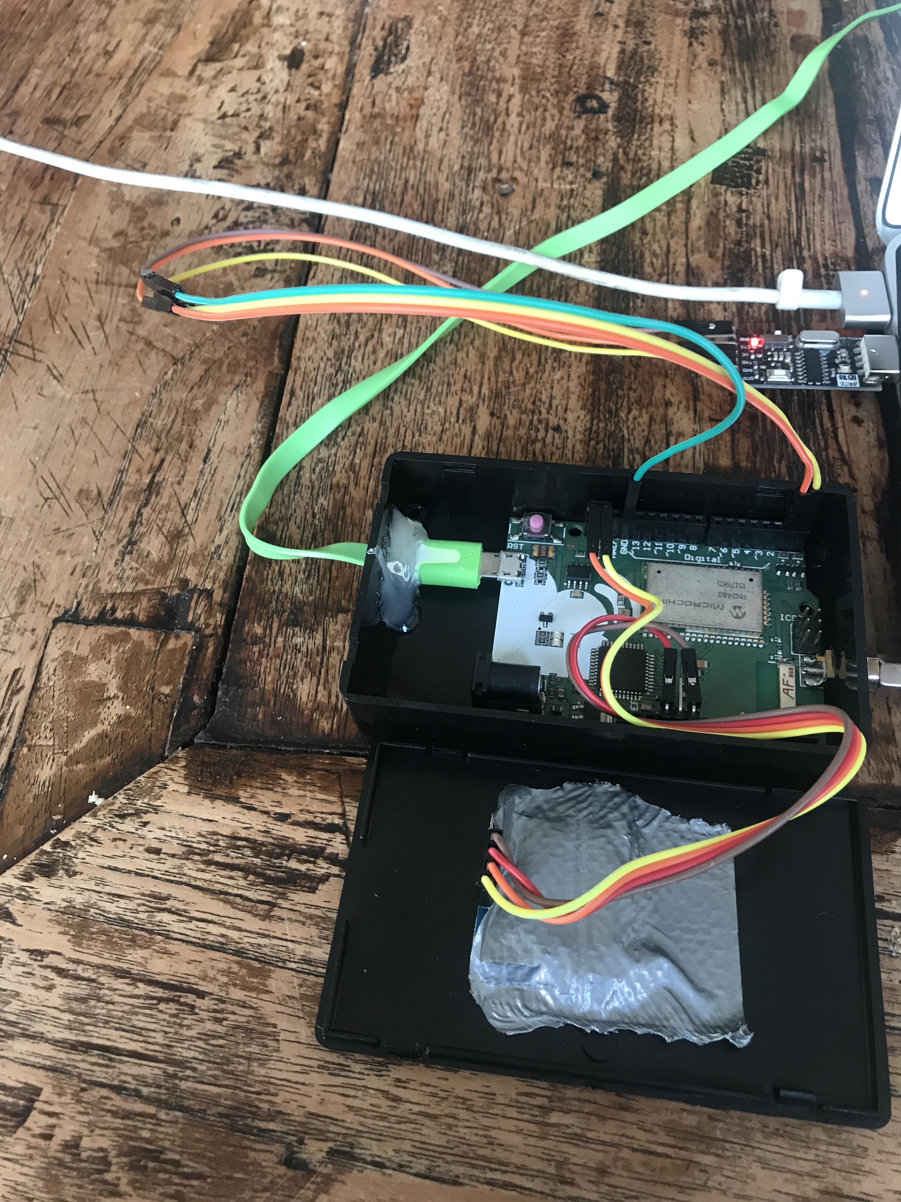

Instructions are ok, but didn’t work on my macbook with parralels and W10. Bricked the UNO/RN2483, but could revive it with a ftdy to the serial port on the Leonardo and the reset option in the loradevutil. Did have to lower bitrate to 9600bps to get it working though.

Used a standard ftdi adapter to the serial pins of the rn2483. Powered board through usb and used the loradevutil reset option to revive the chip on 9600bps. See previous picture for the pinout to the ttn uno.

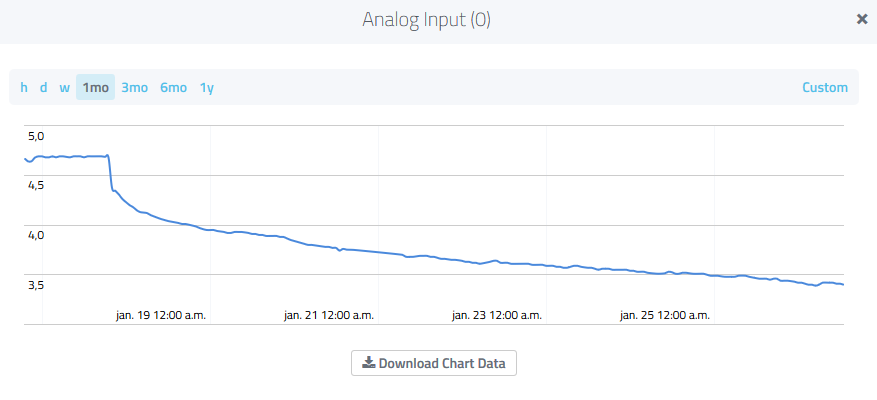

Today I verified operation of my TTN Node. After the firmware update my Things Node is still running: 9 days in a row:
This is the battery voltage of the Things Node on Cayenne

Actually, are you sure that is that good ? I’ve been using a Node 1.0.1 “wardriving” for a bit (I did switch off the motion detection and only did the 5 minute sending an whenever I push a button) and after 2 days of that it also was at 3.9 volts…

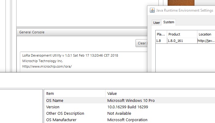

@BoRRoZ I tried the latest DevUtility first and this and the beta version crash with the same error. The Serial USB device driver is from Microsoft, dated 21.06.2006, version 10.0.16299.15. Driver update says: best driver already installed…
I have opend a Microchip support case. There is also a 69K java error log created which I dont feel to post here…

@BoRRoZ Yes, it is/was. Uninstalled two java versions and reinstalled the offline downloada version 8.161 64bit version and installed. The gui now shows up and detects: RN2483 1.0.1 Dec 15 2015 09:38:09 created. Hopefully the update will now work. Thanks…
update: it worked, now I have: RN2483 1.0.3 Mar 22 2017 06:00:09 created
