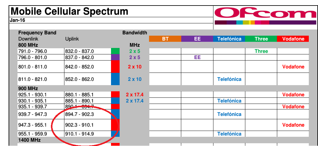

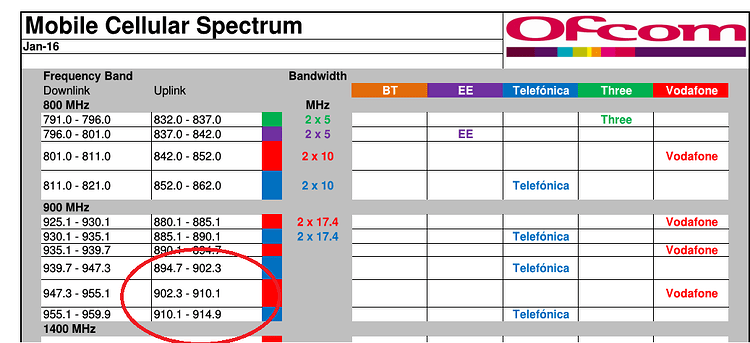

Short answer is no. You can if in a controlled and secure environment wrt RF leakage and polution - so in a faraday cage/RF anechoic conditions…note getting that with LoRa is challenging as I know in early days of testing they had to put an rf cage inside another in order to confirm the sensitivity performance :wink: You should check a) with you local regulator, b) with Microchip & c) with the LoRa-Alliance on how best to approach this or a local test house such as TUV et al. I know there has been a consultation kicked of to look at how parts of what we would refer to as the US915 band (from roughly 902-925) are being considered for a potential harmonisation activity in the future but to best of my knowlege (IANAL) this is still along way off…I believe the consutation is focussed on the upper part of the band as the lower section has significant overlay with UK/EU/EEA Mobile operators…hence if you try and interfere likely you will be tracked down and you will be prosecuted! :scream:
