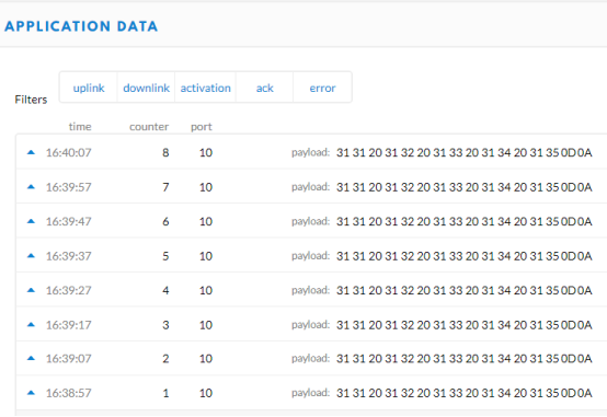

I deployed the lorawan network in China, but I encountered some problems when joining the TTN platform. The problems are as follows:
First, by joining the network through ABP, the node module can upload data to the TTN platform, but the data issued by the TTN platform cannot be received by the node module.

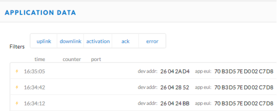

Second, the node module cannot always join the TTN platform through the OTAA mode.
Third, a few months ago I used the same node module and gateway for debugging. No matter it is ABP or OTAA mode, it can upload and send data.

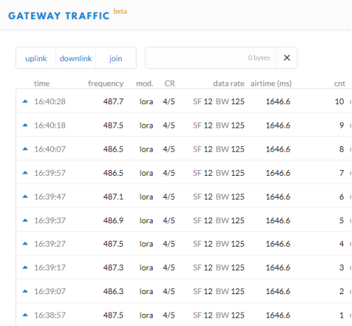

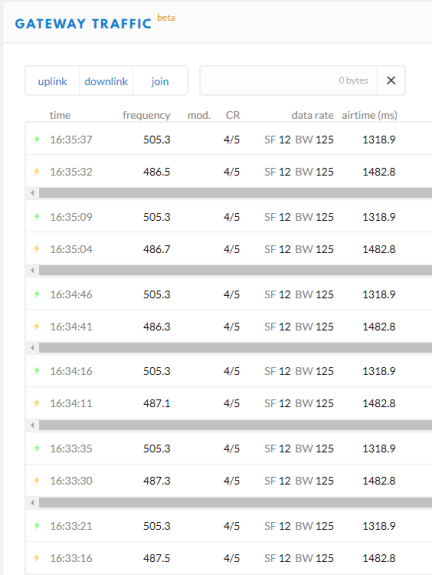

Data in OTAA mode:
Data in ABP mode:
I guess my frequency plan is wrong, it doesn’t match the TTN platform.
My uplink frequency is:
1.486.3-SF7BW125 to SF12BW125
2.486.5-SF7BW125 to SF12BW125
3.486.7-SF7BW125 to SF12BW125
4.486.9-SF7BW125 to SF12BW125
5.487.1-SF7BW125 to SF12BW125
6.487.3-SF7BW125 to SF12BW125
7.487.5-SF7BW125 to SF12BW125
8.487.7-SF7BW125 to SF12BW125
The downlink frequency is:
1.506.7-SF7BW125 to SF12BW125
2.506.9-SF7BW125 to SF12BW125
3.507.1-SF7BW125 to SF12BW125
4.507.3-SF7BW125 to SF12BW125
5.507.5-SF7BW125 to SF12BW125
6.507.7-SF7BW125 to SF12BW125
7.507.9-SF7BW125 to SF12BW125
8.508.1-SF7BW125 to SF12BW125
9.505.3-SF12BW125 (RX2 only downlink)

The gateways and nodes are made by Chinese domestic manufacturers. A few months ago, the uplink data and downlink data were normal, but it has been abnormal since March. I wonder if any changes have been made to the TTN platform.
