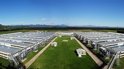

The construction is sandwich panel(5-6 cm foam between metal plate) as you can see from the image, the farms looks like this.
DR is 0 and SF12. Some devices never connects the gateways some messages are lost.
There is only one gateway each a farm but there are 3 different farm on different cities and have same problem on all.

One gateway to cover all those faraday cages is rather ambitious bordering on never going to work and that it is clearly a commercial farm, not really a TTN community application.
