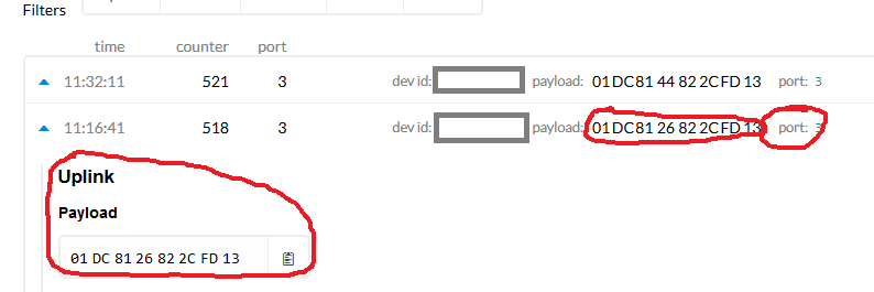

Hello,
I need to decode payload outside of TTN (over node-red or thingsboard).
But I can’t find the TTN setting to received the payload.
I have tried with “HTTP integration” (from TTN to HTTP callback server) and"TTN integration connector" in thingsboard but the problem is still the same:
I get only “payload_raw”, not payload I show in red bellow:
For example, in HTTP callback I have:

Hi
payload_raw is just the same payload encoded in base64.
Try to paste “AdyBBoIs/RM=” in this site https://cryptii.com/pipes/base64-to-hex you will see you get the corresponding hex.
There is plugin in node red to decode base64.
Nicolas
Thank a lot grazy, I will try the “node-red-node-base64”
I confirm : it works now.
raw_payload is now ready to use (same as “payload” with https://flows.nodered.org/node/node-red-contrib-ttn)
