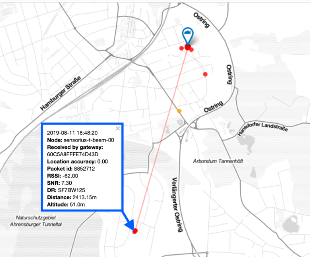

Jens, I just want to let you know that I was able to receive data from a distance of 2413m using the RAK7258 indoors with on-board antenna and a TTGO T-Beam node.
LoRa-Reichweite-00
http://ttnmapper.org/experiments/map.php?name=sensorius-map

This result does not look valid. It’s not possible to get an RSSI of -62dBm at that distance.
Hi @jpmeijers - mmmh, I’m running unmodified paxcounter source on my TTGO T-Beam Node:
To setup my system I’ve follwed the instructions given by the German Make Magazin:
There are 4 transmissions recorded with RSSIs from -62 to -70dBm:
I’m clueless how to verify my measurements. Any ideas are appreciated.
However, the GPS position is the correct one.
Thanks for mentioning that the result looks suspicious.
Who is in charge to calculate the RSSI? The RAK 7258 GW I would assume?

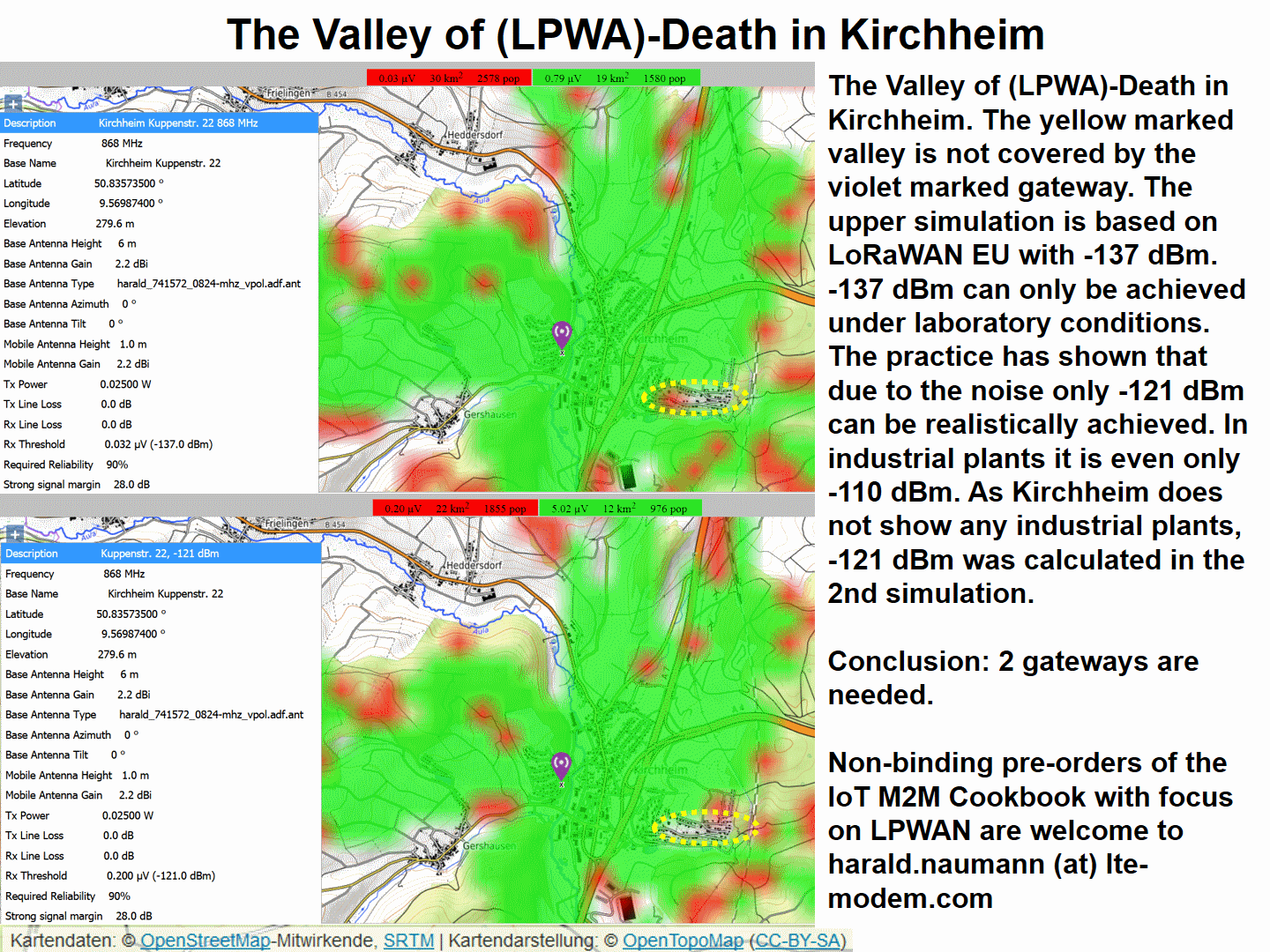

Hi Jens, if you drop me an email and tell me the two coordinates of your gateways, then I will simulate it for you free of charge. I need to know the high over ground and will use 15 dB loss for the roof. If your roof is not higher then the next roof then you can add 20 dB lore loss again. Your gateway antenna has to be mounted higher than the other roofs.
In the picture as below, you find the simulation for Kirchheim in Hesse. The gateway antenna is planned at the violet bubble, 30 meters higher than the main village of Kirchheim.
Private-LPWAN-Kirchheim-4
