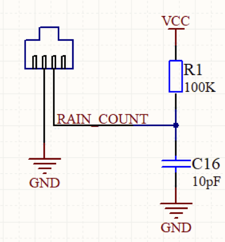

I have a Rain Meter, based on a tilting bucket mechanism. So, on my view at least, it have to be very time critical, so I don’t lose a reading. But a the moment it’s not working properly, the LoRa send job is taking a good part of the runtime.
So, is there a tip that I could use for doing the measurement asynchronous?
Bellow is my code: (if there’s something wrong, please point out)
