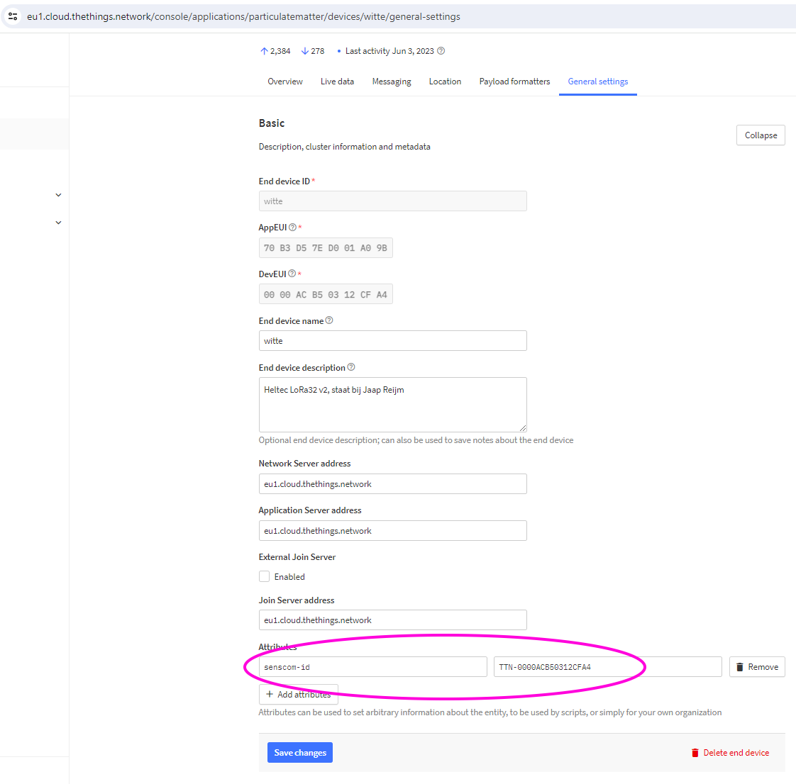

Yes, you can add a device-specific attribute in the console.
However the device-attribute data is not sent with each MQTT uplink message. You need to fetch the attributes in a separate process.

To fetch the device attributes, you can use the end device API, as described here: End Device APIs | The Things Stack for LoRaWAN
My application uses the EndDeviceRegistry.List call:
  • application_id = the id of the TTN application
  • Authorization header with an API key that allows permission to view the device properties (‘view devices in application’, perhaps also ‘view application information’)
  • field mask set to “ids,attributes”
