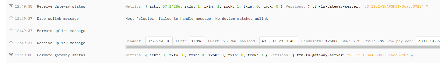

I just added my gateway to the new v3 stack and now I get a lot of the messages:
Host cluster failed to handle message. No devices matches uplink

grafik
With the v2 stack it seems to work without issues.
Why is that? What does the message mean?
Probably all those v2 devices in your area that are transmitting but aren’t setup on v3 so your gateway passes on the uplink but there’s no entry to match in v3.
Which is why we are suggesting people hold off migrating their gateways to v3 until more v2 devices have been moved.
