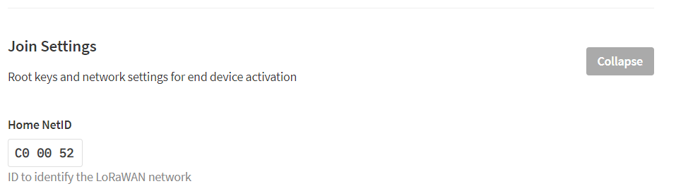

So, in the console, what is the purpose of this configuration: MyDevice > General Settings > Join Settings > Home NetID ?
Changing the value doesn’t work at all. We got confused with it, and it seems to have no effect to the DevAddr range assigned.

The Home NetID option for a device is used for LoRaWAN roaming when the device is registered on a different LoRaWAN Network Server (LNS) and you need The Things Stack (TTS) to forward data to it via the backend interfaces.
The --ns.net_id flag option is the Home Net ID of your TTS cluster and that’s used to generate device addresses.
