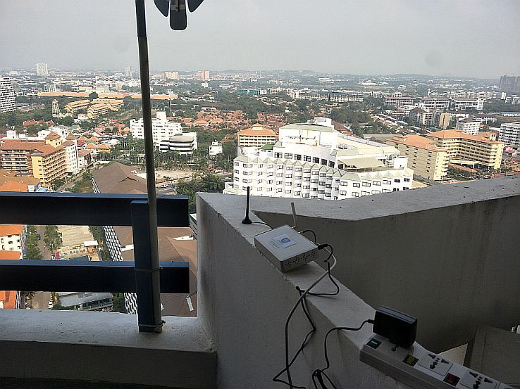

Dragino LG308 is at balcony on 27th floor, my SF12 node can reach the gateway from -1 and -2 of ground floor. image
Somsak
Encouraging !!
