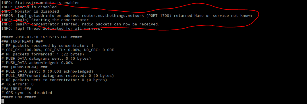

When I execute the command in Raspberry Pi on Ic880a-SPI, i encountered this problem. I don’t know why it is not receiving the response from the server.
Please help.

Your error message indicates DNS does not work. Run ‘host router.eu.thethings.network’, if that does not show below output you need to find why DNS fails. Might be missing internet connection, firewall ports, configuration error…
Thank you Problem Solved. DNS configured to my router was unable to ping route.en.thethings.network.
After I reconnected to different Internet service (Mobile Hotspot), it started working.
