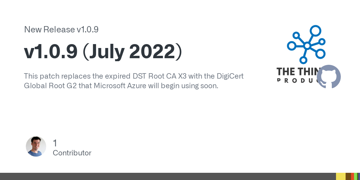

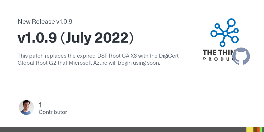

1 the device firmware appears to be 1.05 - even after trying to update it using an sd card using instructions from gateway/firmware at develop · TheThingsProducts/gateway · GitHub and selecting the top stable release. However, once the gateway works this should update OTA.
