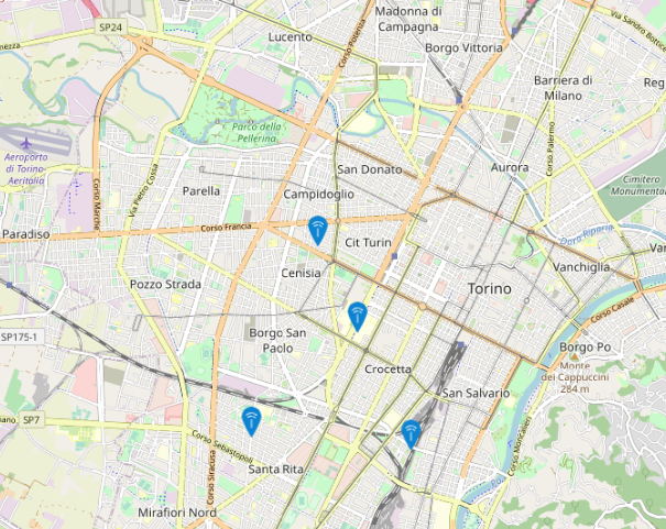

Those are (according to TTN map) the gateways that are on the same city:

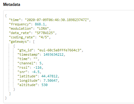

This is what i get on the TTN application web page :
I noticed that the altitude is 530m , could it be a balloon and is it possible that it receives better than the near by gateways ?
IMHO this altitude is referenced to MSL. There seams to be a hill with the gateway on top. The antenna of the gateway can look into Torino from above. With SF7/125kHz theoretically 135 km are possible.
and yes - it is possible that the signal of your node is received better by a far away gateway.
