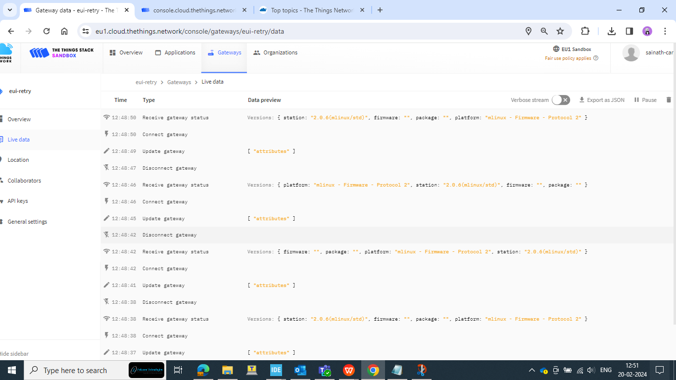

I am facing an issue with the gateway when connecting to the TTN server. It shows frequent disconnections and reconnections within one minute after the initial connection is established. The node is not joining the TTN server even though it is registered with the gateway; the communication is not happening between the gateway and the node.

Sorry for the inconvenience. It is registered on the TTN server. I am using a Multitech gateway, currently testing indoors. There have been no changes to the Multitech gateway and TTN, but I have re-registered the gateway on the TTN server just in case.
This log is from the TTN server. I don’t know why it is acting strangely all of a sudden.

I am asking you to point a browser to the MultiTech, log in and in the MultiTech admin interface check the output of BasicStation. I don’t own MultiTech hardware that runs BasicStation so I don’t know where to look, may-be someone with recent MultiTech hardware can point you to the right screen or (oh horror) you could consult the manual… (old software loads allowed ssh access to logfiles, don’t know if that still works as my hardware is first generation and doesn’t run BasicStation)
