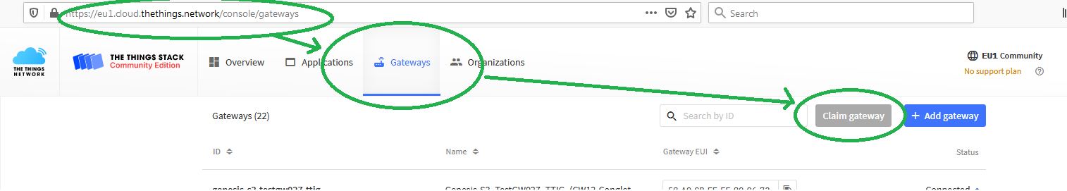

Its should tell you to follow a simple 3 step process per the attached diagramme
  1. Log into you console page - eui1 for europe, nam1 for north america, au1 for australia or where ever…
  2. Select Gateway tab/option
  3. Select Claim Gateway option…then follow rest of instruction/your nose :slight_smile:
No need to involve CLI at this point…as it can all be done in the Web GUI…
Good luck…and as Nick tells you - read the documentation…accessing the docs is made very easy so we dont need to guide people through the process…
