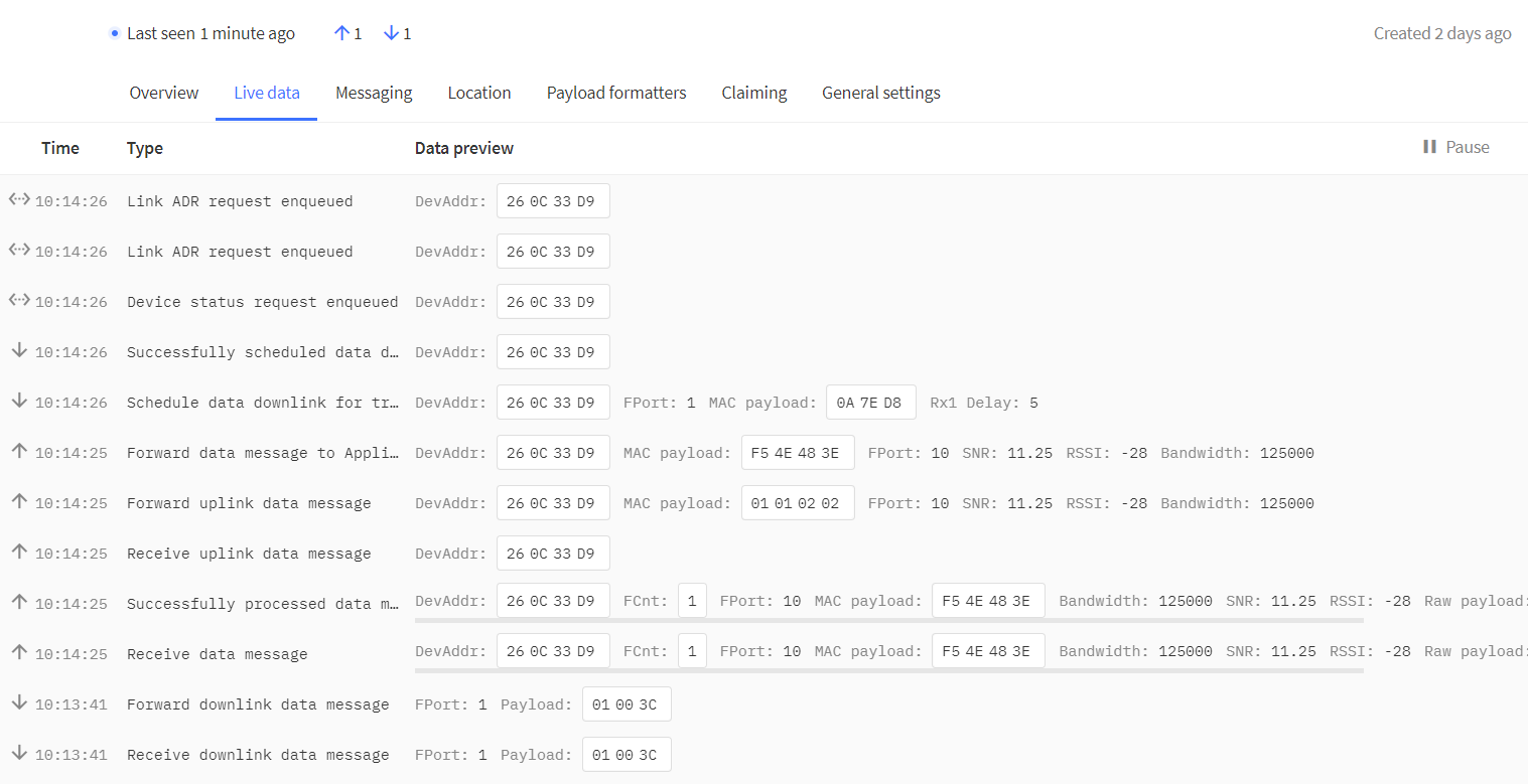

Yes it should. However I found not all devices firmware works correctly with the 5 second RX1 delay used by V3 and as a result your device might be listening for a transmission at the wrong time.
In the V3 “Live Data” view, what output do you see when the device uplinks? (Everything until the next uplink)
And what are the counter values for uplink and downlink? (Next to the last seen value with the arrows)
This is the live data just after join and sending first uplink;
And this is after scheduling a downlink message, which actually was not received by the device after sending the next uplink;

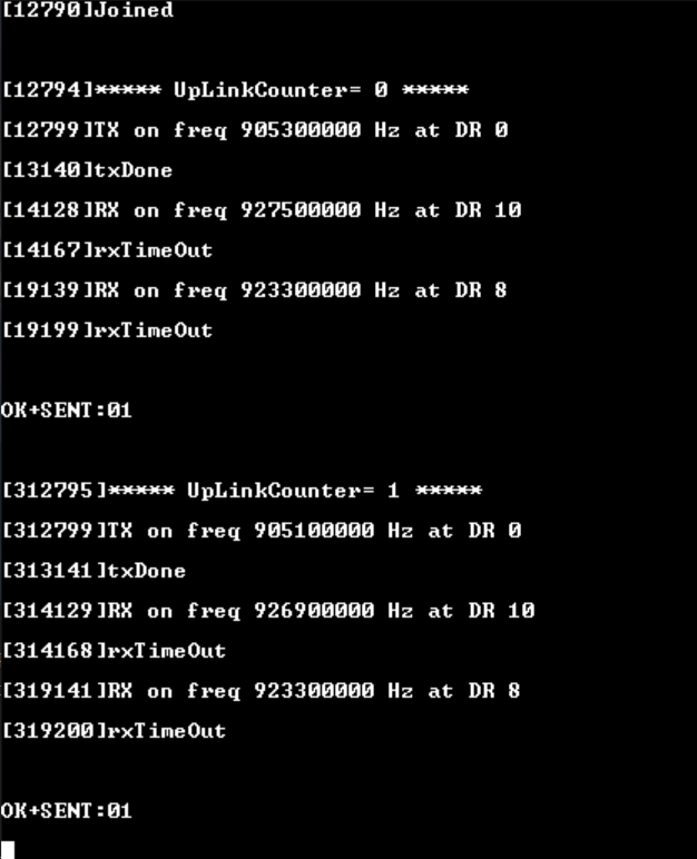

This is the device console (local terminal output from firmware);
As you can see, join accept was received but after that, the downlink is not received…

Have you upgraded to SDK version 4.4? If not you are experiencing a bug that affects RX1 timing resulting in exactly the behavior you are experiencing.
(The bug is in asrlib.a)
