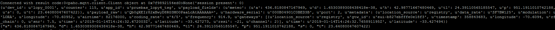

Do you want to do something similar to this?
Captura_ttn
I did this with Python
@BoRRoZ @Mirmit
Not MQTT, and not decoded, but this will give you more insight.

#!/usr/bin/env python
# -*- coding: utf-8 -*-
#<-------- Libraries -------->
import paho.mqtt.client as mqtt
import paho.mqtt.publish as publish
import json
#import MySQLdb
import time
import datetime
import dateutil.parser
import base64
import requests
#<------ Configuration ------>
#TTN Configuration
TTN_appeui = ""
TTN_appid  = ""
TTN_password = ""
TTN_tls_path ='mqtt-ca.perm'
#<-------- Functions -------->
def on_connect(mqttc, mosq, obj, rc):
    print("Connected with result code:"+str(rc)+str(mqttc)+str(mosq)+str(obj))
    # subscribe to specific device in a specific app
    mqttc.subscribe('"')#app_ID/devices/+/up
def on_subscribe(mosq, obj, mid, granted_qos):
    print("Subscribed")
def on_message(mqttc, obj, msg):
	try:
		#Formato Json
		x = json.loads(msg.payload.decode('utf-8'))
		print(x)
		data_enviar = x['payload_fields']['meteo']
		data_enviar2= json.dumps(data_enviar)
		print(data_enviar2)
		print("------------------------")
	except Exception as e:
		print(e)
		pass
#<---------- Main ----------->
mqttc= mqtt.Client()
# Assign event callbacks
mqttc.on_connect=on_connect
mqttc.on_message=on_message
mqttc.username_pw_set(TTN_appid, TTN_password)
mqttc.tls_set(TTN_tls_path)
mqttc.connect("us-west.thethings.network", 8883, 10)
mqttc.loop_forever()
