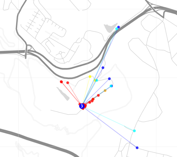

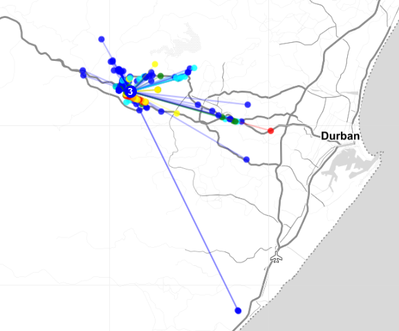

This gateway (Mikrotik) have a 6db antenna and is at 635m and it is 35+Km to Durban, clear LOS to the see, it picks up reliably nodes in Durban (recently migrated to V3 so all V2 data missing). You will notice hardly any points to the SE, this is due to a tin roof 25m away blocking the RF. I cant lift it above the roof so I have to live with it.

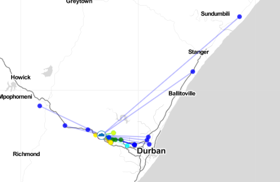

This gateway is at 950m (clear LOS, 360 for +50KM) and if I recall correctly only the internal 3db Mikrotik antenna, longest distance between node and gateway Distance: 105698m me travelling at 120km/h on the freeway,
This gateway is actually place indoors (Multiteck) with a 3db antenna, max range 1300m.
So terrain blocking plays a big part in area you can cover.
