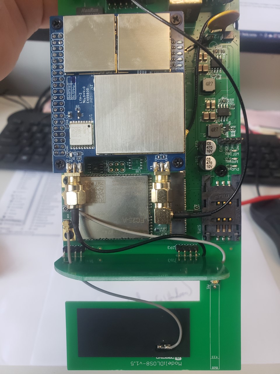

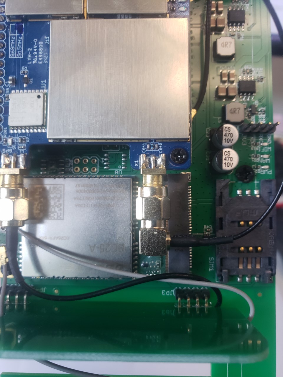

We dont have any cards, I am including two pics of the board.
thumbnail_20220729_134952
thumbnail_20220729_134945
That blue pcb with the tin color modules is the LoRaWAN concentrator card. However given that it has been mounted with four screws it’s unlikely it has a bad connection.
